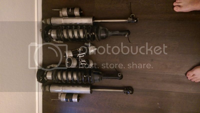

Originally I wanted to go with Radflo suspension but I got a smoking deal on some used standard travel Icon coilovers with remote reservoirs. They are in really good shape and I picked them up for $600 so I couldn't pass them up.

Do I need to upgrade the UCAs to fit the coilovers in place? I was going to replace the UCAs at a later date, if I can wait.
That's an absurdly good deal. I'd have done the same. I believe the standard travel coilovers will fit with stock UCAs.
Yeah I really wanted to go extended travel but the price was right.
I am going to install the coilovers with the stock UCAs and see how it goes. It will likely be staying close to stock height until I get some rear coils and shocks, and don't forget tires.
you will be fine with stock UCAs on standard travel
All right we'll I have the shocks and coil overs I just need to rebuild the rear shocks.
