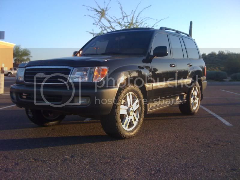

'07 Tundra 20" wheels installed on my 100 series **Pictures**

285/75/18 - Tundra wheels are same offset as factory 100 wheels.

size above. I havent twisted it up offroad yet to see how it all really fits but I'll more then likely have to lower the rear bumpstops. Yes, I did bang that pinchweld behind the tire over (took longer to move the fender liner). And ya, I trimmed out the "bubble" of the liner. Havent had enough snow to really get it packed in there but last week I did get a decent amount in there and same as before, it just moves. Thanks for the compliments.

When I made this thread, I mounted the Tundra wheels with the stock 275/55/20 Bridgestone Duelers and I ended up getting 65k miles out of those tires. I finally needed tires and found a nice (unpassable) deal on some 305/50/20 Nitto Terra Grapplers. I expected to lift the truck soon but haven't yet. I had the Nittos installed today and to my surprise they fit really really well. The guy installing the tires test fitted just the fronts and we took the truck out on some larger rocks in the landscaping by his shop and flexed the tires as far into the wells as we could get. There is no rubbing lock to lock, even after a light trail test stuffing the tires into the wells on my own afterward I couldn't get them to rub. Just thought I'd post this incase anyone cares.

Tires worked great, did a trailride the other night on Oso Mine trail off of the 4 Peaks road and did a pretty gnarly loop at the backside of it up some a steep and narrow trail, sharp loose rocks mixed with a lot of crossups from washouts on the trail. Great traction all the way through, absolutely no rubbing. No really good pics from the ride but trust me, it was beautiful. Arizona desert/mountains this time of year are something to behold.
Do you think if you had mounted the TGs in a 305/55R20, they would rub? Basically the same width, but 33 inches tall instead of 32. To ask a simpler question, how much clearance is there at full lock/ compression.......im mainly concerned with the front, the rears on these things could eat a person.

Full lock and stuffed, you would probably get a little rub on the back side of the front fender until you wore them down a little. I could get it sooo close, but no contact. The extra 1/2" probably would have rubbed a little. Even so, it would be very minimal I think. Enough to where I wouldn't worry about it anyway. I really like the width, especially in the loose sand of the washes around here.

Thanks for the info......i love wide tires as well. Do you think a 12mm body lift (like what Loud and Spresso have) would prevent the rubbing?
