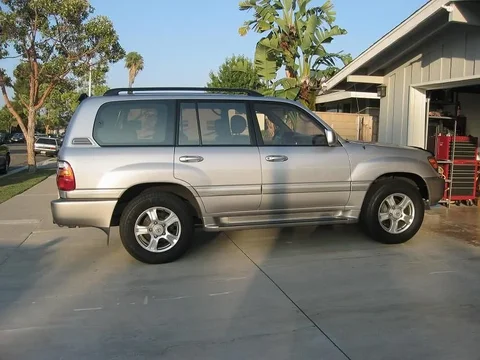

'07 Tundra 20" wheels installed on my 100 series **Pictures**

OK photos - 18" Tundra Alloys. Basically bought them since the takeoffs (wheel/tires) were cheaper than 4 new LTXs on the 16" stock rims. Looks good tho, updates the truck and they ride better. They bolt up easy as stock - except the front center caps. Just follow Kyoso's write up.
You can see how the stock center caps protrude. Used the rear Tundra caps. Otherwise happy - hope this answers some questions about the Tundra 18's
They look good, but it would drive me nuts with different caps on the front vs. back. I don't mind the protruded look as the stock LC wheels had a protruding cap anyway. Definitely a clean upgrade though, they look like they came on it from the factory as an option. Are you reselling your stockers? That'll make that set of tires really cheap:cool:

Update, new wheels and tires are on. Wow what a difference, looks way better IMOP with the bigger wheels. I can't ever see myself going back to the 16s. They just look way too small in the 100 series wheel wells. I much more prefer the Tundra style wheels to the stock LC ones. Very happy with the price (350) and out come of this. Also do not know what the deal is but the stock 100 series hub caps fit on the Tundra wheels with no problems. I did not need to alter them in anyway. Just put them on, they did take a little persuasion. It’s still possible I could loose one off-road but this is the wife’s car. She just uses it as daily driver. I will let you guys know if I loose one. I took some measurements, stock then with the new wheels.
