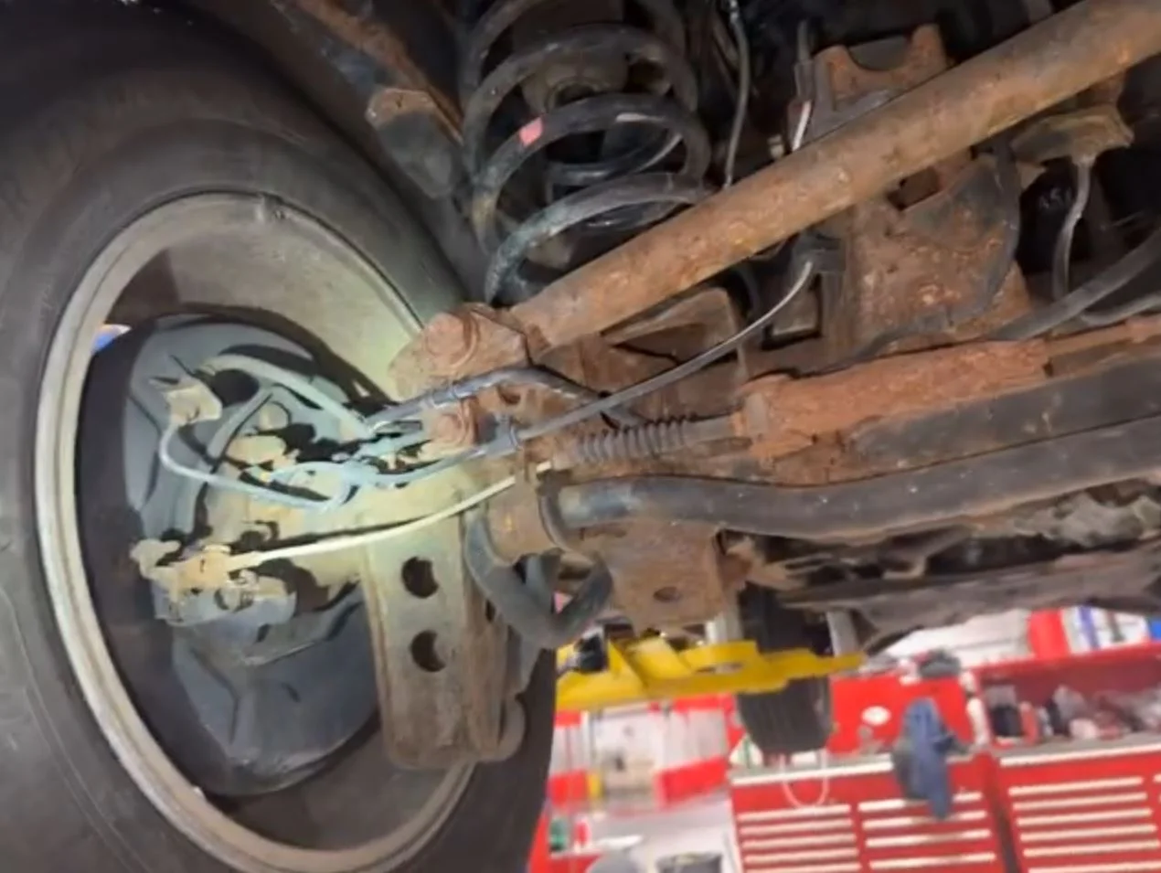

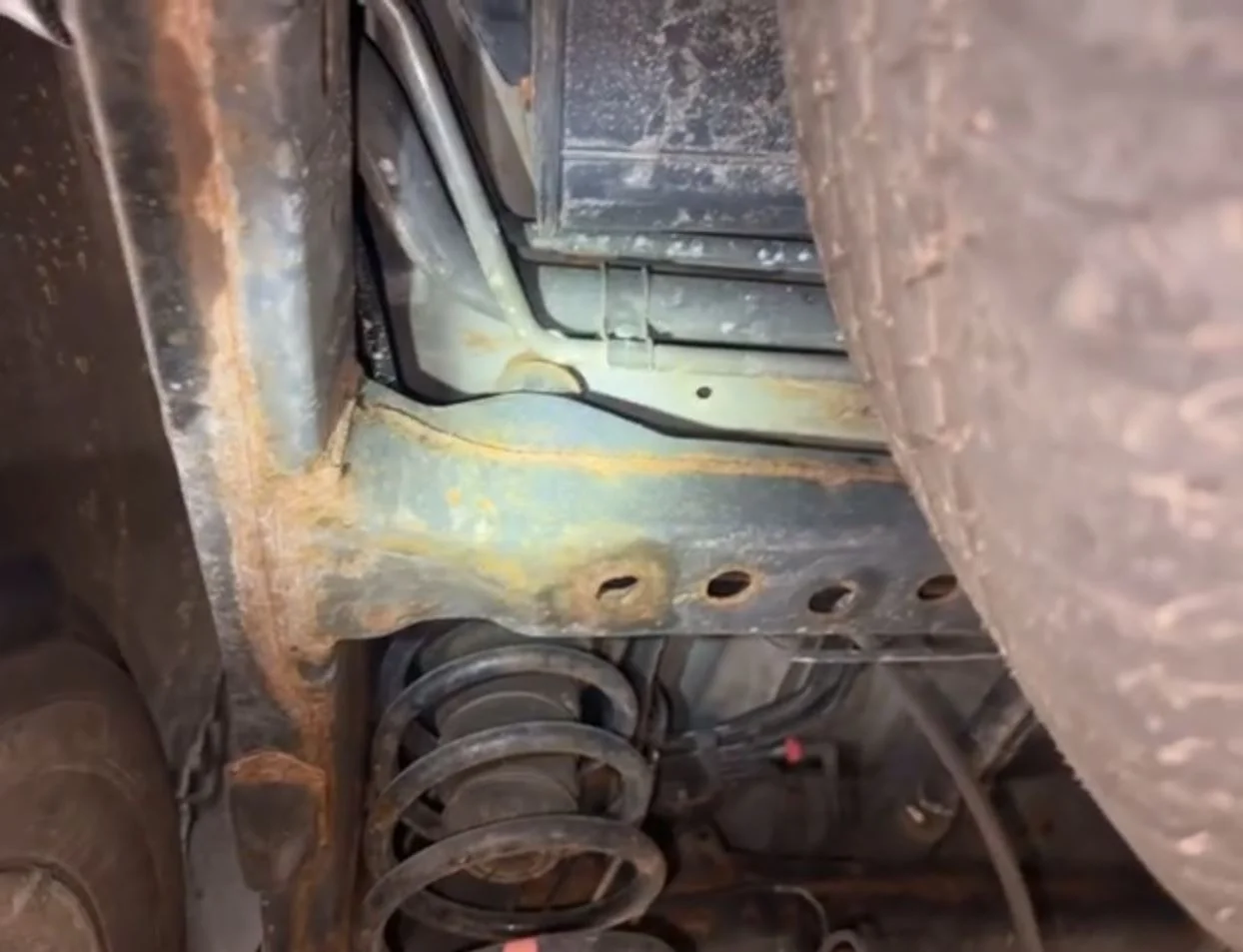

Also, i got the car from the east, doesnt have any major rust on the frame, some surface rust which i would like to tackel and not think about. Doing some googling and couldn't find any auto body shops that did undercarriage rust treatments. Any recommendations?

Do you have pics of the rust you want to address? I work on my own stuff so no mechanic recommendations, sorry.
I attached a couple of pictures, i was looking to treat/resurface

Looks like surface rust to me. If you can't use something like Fluid Film, I bought 6 cans of CRC heavy duty Corrosion Inhibitor, which dries like a waxy covering that is tough to get off. It's not a rubberized coating, so it will need to be reapplied every few years. But I like it as it can soak in while it's wet and seals nicely. I bought an 80 series that has a little crust on the under carriage and once I knocked off the loose stuff sprayed this liberally all on the underside and it has held up nicely. It's about $10 per 10 oz can, and I used 5 cans to coat the underside of my truck.

So just go under the car, and go on spraying everywhere including the inside of the frame? Should you use a rust remover first/ wire brush before tackling it?
and yes got it checked out and everyone stated its surface rust, frame is solid. Just want to tackel it all, and not think about it.
Thanks for your input and help

Yeah, mine was worse than yours, for sure, and I just knocked off anything loose. I actually used a pointed planishing hammer (basically a body work hammer with a pointy end on one side) just to break away scale, but I douby yours is that bad. I cleared away any dried mud and basically got down as close as I could to base metal. BTW, almost all of my "bad" area was from the rear doors back. So there wasn't a massive amount of area to cover. Anyway, once it was prepped, and I'm not talking about the surface being "clean" just cleared so the spray came permeate and seal, I then went crazy spraying as much of the rear area as I could reach. It's been a couple years now and I've driven up north a couple of times and see no degradation in the coverage. Most likely I'll take a pressure washer and wash as good as I can underneath, this summer, and buy another 6 cans and reapply. It will just keep building up and will stop the rust. Also, because I'm paranoid, I'm going to try to wash out the inside of the frame rails and use the Eastwood in frame sealer, that I used on a FJ62 project. It's a very good internal sealer.
