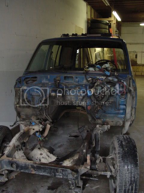

Next I pulled everything that looked like it might be of value from the BJ60 and started trying to sell the stuff I didn't need...
since I began parting it, I've sold well over $1200 worth of parts, with pending sales that will put me over the original purchase price while leaving me with a nifty 3B and 5 speed for my rig (affectionately known as Brown Sugar).

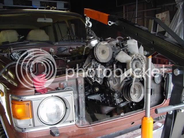

Then pulled the 2F (still for sale!)

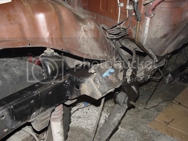

Welded in the engine mounts that were loving sawzalled from the BJ60 frame, which itself was chopped up and is now well on it's way to becoming re-bar...

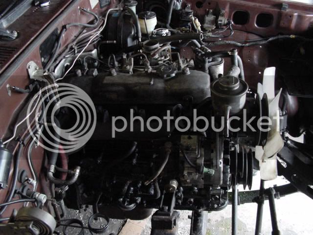

installed the 3B/H55f combo...
and that's where I am now!
