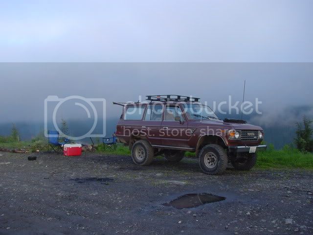

Howdy all. Still working out the bugs (i.e. cold start issue, heater blower issue, tach no worky issue) but for the most part the rig is doing well. I had to add some spacers between the transmission support member and the mounts because the fan was contacting the shroud when I was bouncing around the mountains... and going over potholes in town for that matter. Fixed that today. Here are a few pictures from a little camping trip this past weekend up in the North Cascades. Enjoy!
