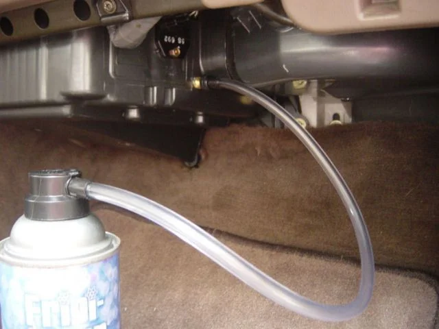

My most recent 80 came with the funk of cigar smell. The only item left to clean was the AC system and specifically the evaporator, which is where a lot of foul smell and mildew gets trapped. For you non-AC types, the evaporator looks like a little radiator and lives up inside the dash and has refrigerant passing through it....its what the fan blows across to give you cold air.
So after a thread or two here I discovered BG Products' Frigi-Clean system, made especially for curing this problem. And as if things couldn't get any better I discovered that they have a warehouse 10 minutes from my house. :D
It comes in an aerosol can along with a standard pneumatic fitting that you install in the evaporator housing. With simple printed directions and a quickie 1/4:banana: install I foamed and cleaned the system in about 10 minutes. It foams and rids the evaporator fins of mildew, nicotine, dust and funk. The residue runs out the AC drain hole onto the ground. I followed it up with their Frigi-Fresh Antibacterial Air Freshener, which as a last step you spray into the cowl vents. Wow, what a difference. Even before the air freshener, it knocked all the smell out of the vents. And whenever I want to do it again, all I have to do is get another can and attach it to the fitting and push the button.
So forgot air fresheners and sprays that cover up the smell, solve the problem by killing the bacteria and mildew at the source. $25 total from BG Products.:cheers:

So do you tap into the evaporator?
Huh... $25.00 eh, I might have to guive it a try
LOOKING AT THE PICS (:flipoff2: ) you'll see in pic one a brass fitting and in pic two, the clear line running to said brass fitting. Drill a 1/4" hole and screw the fitting in. Attach the hose, start the truck and push on the top of the can to discharge the foam. You are cleaning the exterior fins of the evaporator, not the internal plumbing.

Based on what I saw when I had the lower half of the evaporator housing pryed slightly apart, and based on what ran out onto my driveway when I foamed it, my AC is only getting better. Even if I have to run another $14 can through it, its better and cheaper than evacuating the AC, removing the evaporator and putting it all back together.

I just got back from a 45 minute drive in my 80 and the AC is clean as a whistle. I am not going to tear the lower unit apart again to see what it looks like (that was the whole point in this exercise), but it smells like new. Actually, it has NO smell whatsoever. Its hot and humid here this afternoon and I now have it parked in the driveway, cooking. We'll see what :princess: says when we get in it tonight headed to dinner.

You don't have to know anything about AC systems to do this. You drill a hole in the evaporator housing (see pic) and plumb in the adapter (it is essentially a shortened, screw-in valve stem). Attach the hose and the can, start the truck and open up the AC and hold down the top button on the can. It takes about 15 seconds to discharge the contents of the can into the evaporator housing under the dash. You then kill the truck and let it sit there and soak for 10 minutes. Start the truck, run for 10 more minutes, hose off the driveway and you are done.

Actually, it looked like Coca Cola. I am sure it was all the nicotine and varnish that was stuck on the evaporator. Quite foul.

Thanks Ken. Day 2 and the sour, smoky mildew smell is completely gone when I fire up the AC. As humid as it gets here, I am thinking this may become a semi-annual ritual.
Instead of drilling, would removing the resistor and spray into the box work?
It would probably make a big mess. The idea is to fill the entire evaporator housing up and engulf the core with foam and let it soak for 10 minutes. Based on where the resistor goes in and the big hole it leaves when you take it out, a lot of foam is going to come right back out and into your passenger floorboard. Also, you are supposed to run the truck and the fan for 10 minutes after foaming and you sure can't do that with the resistor out.
Mine must have been pretty gunked up because my AC is definitely blowing colder than before.
