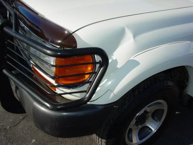

We always tell people they should get ARBs over Brush Guards that Brush Guards are really damage multipliers.
We have pictures to document why Sliders, the benefit a Front ARB, but I don't recall one before of why not a Brush Guard. Found one surfing eBay and thought I would post it up.
This obviously was a small hit by the lack of major damage to anything else and the guard has been pushed most of the way back, but not all the way.
That's about a 1,500 dollar dent there.
Cracked the front of the flare, too. :(

The same thing hapened to me a week after I got my 80. I look at it like just another excuse to buy an ARB sooner. Just work the dents out yourself with a little muscle and use the money saved for the ARB.
I'll quote Adrian from Slee's and say "Paint and chrome won't get you home!"

I'm reckon the damage would have been much worse without the brush bar.
I would assume the same thing! Although not as stout as an ARB even a fairly cheap brush guard has to be stronger than the sheet metal. I guess there might be certain circumstances where the brush guard could cause a bit more damage but most of the time probably not.
You reckon wrong. Might have broken a headlight, might have broken a side light, maybe the grill. None of which are expensive. Probably wouldn't have broken anything, even less expensive. Any dent in your fender or hood is at minimum $400, and probably 2 or 3 times that amount.

Too hard to tell from that picture, but my guess these guards have save a lof of grill, radiators and coolers etc. this extra protection when confronted with a deer or other unexpected obstacle can mean the difference between driving back to the highway or walking back. I've seen it twice myself. I wouldn't put one on just for the weight savings, but I wouldn't take one off if it was already there.
That guard might protect those parts from a collision with a crow or something, but not much else.
A real bumper will do what you say. What is being discussed here is commonly called a "brush guard", they are more of a decoration. The difference is mounting and construction, the damage multipliers are typically only mounted under the bumper and not very strong. In the event of even a relatively minor hit, they hinge back from the mounts, often taking out both fenders, hood, etc, in what would have been a relatively small damage event if not equipped with the damage multiplier. Looks something like this:
