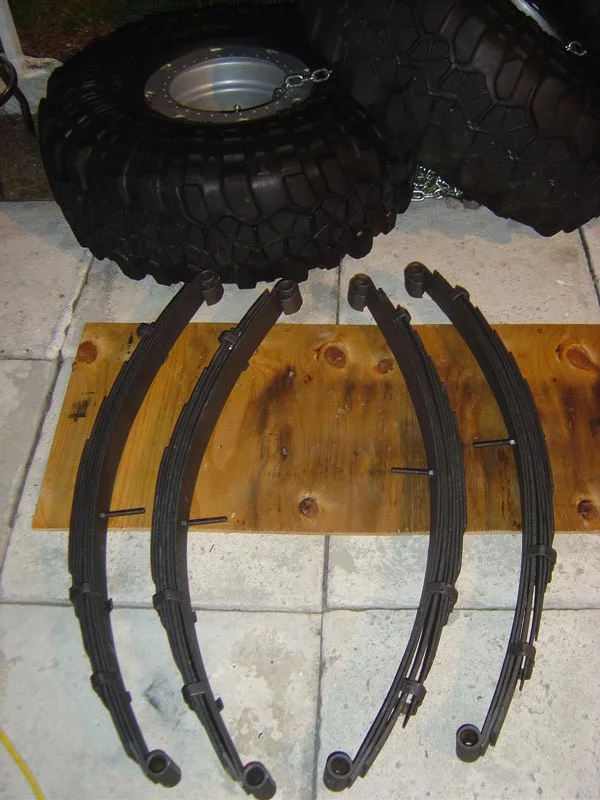

Spring Packs Ready
Seems like the mundane stuff takes longer. I think the front springs are always flatter due to perch locations on frame - but it's obvious in the 2nd pic that the lower leaves weren't willing to play well with the add-a-leaf - figure they'll settle big time once some weight sits on em - hope so - want to get close to flat.
