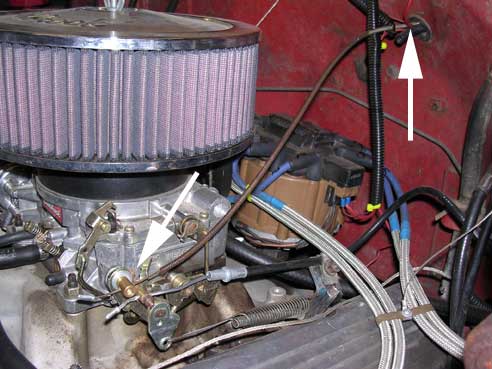

My rig had a choke that was not being used. cable was just tied out of the way (as it is not needed on my engine/carb setup) and knob just sat dormant. So, I rigged up the choke to attach to the Edlebrock carb at the throttle arm.
Now, I have a hand throttle that allows me to increase RPM's (up to well over 3000 if I wanted) - which I used yesterday wheelin up some hill climbs - without the gas pedal and it has the side effect of being a cruise control on the road (except, obviously, when you hit the brake it does not terminate the cruise control).

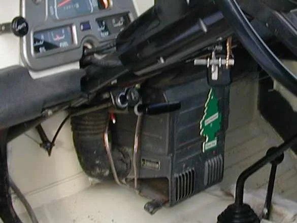

seen here. i thought it was stock? attaches to the gas pedal itself, scary to use at speed because as mentioned you have to reach down to turn it off
interesting... not seen that before. mine is the CHOKE knob right on the dash right in front of me.
i couldn't tell you for sure but its got a little picture of a butterfly opening (like in a carb, can't really explain it too well) so really you could call it a choke knob. maybe its just been relocated but its a pretty clean setup so i assumed it was stock. i do still have the manual choke hooked up on my dash
I also have the hand throttle that I thought was stock, is it a canadian thing? Same location as yours (chuglife) mine says "throttle" on it. Looks pretty stock to me. I also have the manual choke still hooked up on the dash. Have used this as CC, but not for very long. full out seems to be about 110km/hr. one click in about 95km/hr

If I remember correctly this option is for a PTO set up. Can you take pics of braket. I'm curious as to how it is attached.
Yes, the hand throttle under the dash is stock for the PTO, for the two barrel carbs, attaching to the pedal (there are still some kits at SOR, I think). The one barrel carbs had an in-dash that went directly to connect with the carb itself. I've posted pics before (of both ends) that might even show up in a search! :rolleyes:
Thanks.....I think I will slap this set up on the 45 wagon I thought I had most of the hard hardware but the more I read, I'm thinking the shaft that comes from the PTO going back to the PTO gear box is not the same length or is it as the fj40. I think the PTO hardware was removed off a 76 fj40.
