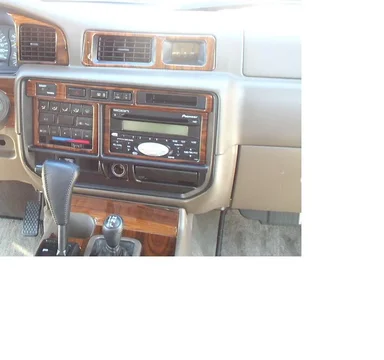

can ya post up a pic?
Here it is. I haven't trimed the face plate here. It is just sitting loosely.

Locked97, do you have to do anything special in addition to unhooking the amp? Aren't the speakers wired to the amp? I like how it looks. I've been looking hard for a stock Toyota head unit that is satalite radio ready. Any more info you can provide on the install would be greatly appreciated!
I installed the scion radio in my 95. I trimed the side of the radio to fit. I used the set of grey conectors and unpluged the amp and it works like a champ. I also installed the OEM XM satelite box to it. It is awesome
