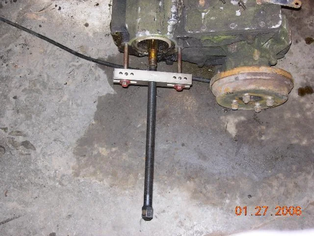

There was talk about seperating the tcase from the back of a trans. Sometimes they fall off, other times, they are stubborn the whole way.
This works EVERYTIME, without fail:
:beer:
  • Like
Reactions: SMG
Does no one read a sigline? ;)
Looks like moss to me also....was dropped off at the shop last week....I am just the middle man. :)
FYI- Long 10mmx1.25 bolts are from mounting the alt on 2F engines...
Snap on puller bar and long pressure screw...
:beer:
They are very easy to put back ;)

Also, you may want to keep an eye out for the short spacer on the shaft that sometimes stays on the shaft after the tcase is pulled off. It may be snug against the back of the transmission - at least it was on my stock 4 speed tranny.

There is no quandry- The spring goes towards the trans, period.
