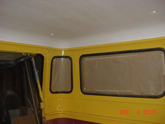

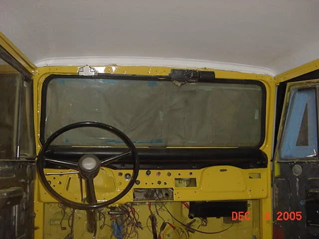

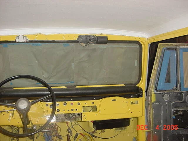

just finished up....new "headliner" installed....took all day...sanded top...applied 3 coats..real slow to dry in this cold ars weather....next prep floor and install durabak...what do you guys think?

i know you see it hanging out of the dash:eek: .....i know it looks out of control but believe me i have it all figgerd out.....maybe...i hope....i just have a couple of loose ends to tie up.....rear lights...dome light of some sort and fuel sending wires...i will know more by weeks end.....thanks for your concern:D

i sanded the roof surface with a 120 grit sand paper on a dewalt orbital sander...i then wiped the surface down with a damp rag...shop vac the perimeter edge and rolled and brushed 4 coats of a product call sno roof...sno roof is usually used on exterior building roofs...i found it to be a very serviceable product for this install...the manufacturer claims 500% elasticity...it looks great in person and i am sure will last a very long time....much cheaper than a new headliner...a 1 gallon can cost 19.99 from my local ace hardware...hope that is enough info...if not just let me know
