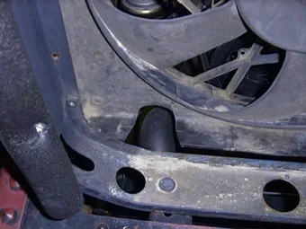

I do not know if you will have the clearance to run a Mark 8 fan with the straight six, but as far as I know it is the bad boy of electric fans.
The bonus is if you can find one, cut off the plastic ears that are molded into the fans shroud and screw on some sheet-metal tabs at the corners.
Now with a little bit of tweaking the whole factory shroud should fit (attached by the sheetmetal tabs with more screws) over the outside of the radiator mounting bracket.
Then source some insulation like they use for pipes in the winter and cut to fit and you can seal up the gaps between the radiator and the mounting bracket.
Now you will also need some heavyduty relays or 100amp solenoid as that fan pulls a gawd awful amount of juice on fan spool-up.
Another cool thing as the fan is two speed, so it is a fairly simple process to have a manual overide for the low mode and let the high speed run off a temp sender. Or however you want, when I ran that fan I had it energize off the temp sender so it would run after the engine was shut down for general purpose engine bay cooling, not a performance thing, but was kindve funny watching friends get startled when the fan would kick on because of the heat soak that happens to the radiator fluid once the pump stops turning and the water in the block cooks and expands toward the overflow tank. This would kick on the sender at the thermostat and fire up the fan, again dont know if it helps any, but newer cars do this.....

The I-6 motor should not need a fan this big for cooling, and I dont think the taurus and the Mark8 are the same beast, but perhaps they share the same electrical motor, doubtful though if they were the same I would expect the electrical draw to be similiar, this one will pop a 30 amp fuse all day long on start up. Course its a junkyard fan maybe the motor needs a bit more juice to turn over than a freshie.
Here a couple of pictures to add to this thread.
