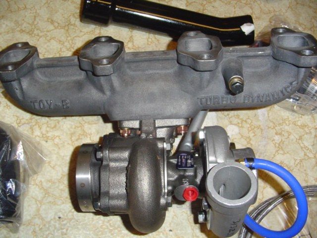

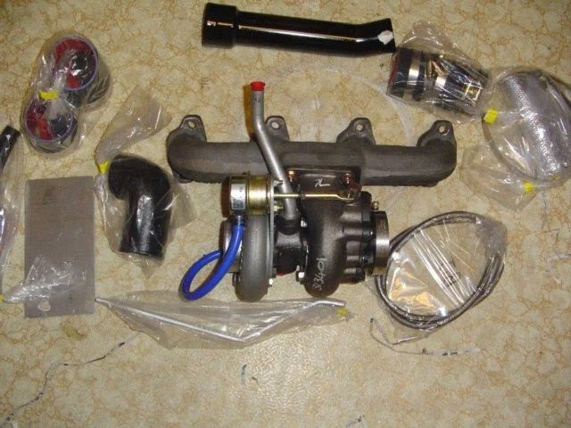

Safari boasts the pulse manifold, equal length runners would be ideal in the real world but prolly not from a manufacturing stand point.

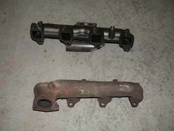

Only one good one so far. The above is the 13B-T manifold all shiny and new out of the box, showing the sweet mounting position of the turbo with even lengths for gases from each cylinder to travel to the turbo.

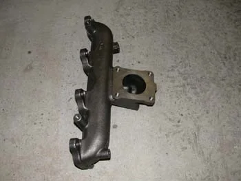

Below is a comparison shot with the stock 3B manifold. Some people have had good luck simply flipping the 3B manifold, I attached a picture from the web of someone who has done this.
Craig.

Lumpy is that a flange on there u had made? The ct26 from the mr2 would bolt right on there with a different flange it looks like.

No that isn't a flange I welded on, that is the stock Toyota surface. I very strongly believe (99% sure) that a CT26 from an MR2 (not, repeat NOT FROM A SUPRA) would bolt right up to that manifold, as Toyota likes to make many of their parts fit one another.
