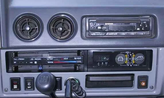

Where can I get this?
Looks like they arent in stock!

This is a dash mounted type from a 4runner or Tercel on Ebay US
It's probably supposed to be plug and play, but on my 5/1985 FJ-60, I didn't seem to have the socket on the wiring harness. The inclinometer came with a four terminal plug: one always hot lead from the battery (to keep the clock time), one swtiched lead (to display the clock time), one lead for the instrument light and one ground. This is the message I got from SOR Tech:
"There are green wires for dash lighting, and black wire for ground. The blue and red are for the clock. One of these is for the clock memory the other is to show the clock read-out and is generally switched with the ignition. You can not really damage the unit hooking it up wrong."
For the battery, switched and ground leads, I spliced into wires going to my non-stock radio wiring. The PO had cut the OEM radio leads and had pulled in sources from other places anyway. I pulled the insturment light feed from one my ARB locker switches, since I had already cut into the OEM harness for that. Recently I've been trying to limit the number of mods (cuts and splices) I make to the OEM harness.
The instrument light in the inclinometer doesn't dim with the rheostat. To do this you would need two separate wires, one for the 12v feed from the running light switch and one "ground" back to the rheostat. The inclinometer only comes with one light feed and one common ground. But I think the inclinometer is far enough away from the driver that it doesn't really matter. The clock light is brighter when the instrument lights are OFF and dims when the lights are turned on. I guess the thinking is that at night, the clock light doesn't need to be as bright to read. That's cool.

Hey... bringing this guy back to life. Was wondering if anyone knows how to get a clock connector (i.e. the connector that would be coming off the clock and would plug into the harness). I'd like to use one to wire up my radio so I don't need to cut n splice.
I believe it would be a four terminal connector
Thanks!
Tim
Try calling SOR as they have lots of things hanging around that are gently used parts. That or go to your local Pick N Pull or salvage yard that has 60s in it and see if you can find one.
There are several good threads on this.
Inclinometer Wiring in a 60
I installed mine w/o splicing the harness by taping into 3 existing/unused connectors behind the dash. Took a little time to locate the matching connectors and make up the pigtails, but very doable.
