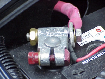

are you talking about these?
those are nice definatly plan on using military style battery terminals but I am asking about the cable terminlas

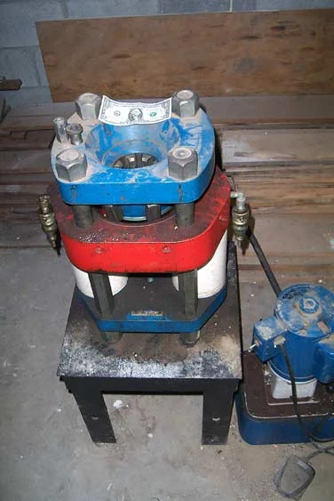

The crimper in the upper pic can be had at NAPA. FWIW, I use the shrink tube with the adhesive inside which seals the lug and wire after crimping.
Here is one link if you want to get a better crimper.
