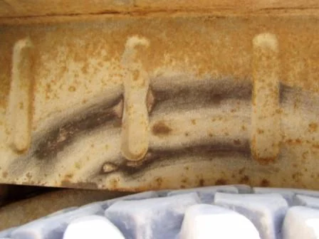

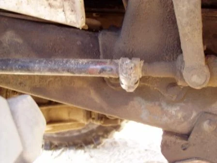

They do rub, in two places. One on the drag link from the stock steering box to the center are, this only happens when hard left and at full stuff.
https://forum.ih8mud.com/attachment.php?attachmentid=168007&stc=1&d=1187833371
two they rum in the rear wheel wells under full stuff/full drop like when you are twisted.
https://forum.ih8mud.com/attachment.php?attachmentid=168008&stc=1&d=1187833516
