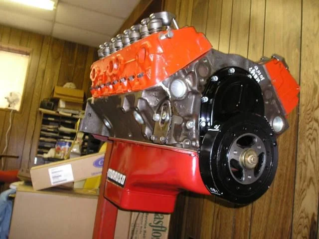

The 350 it had was shot, huge grooves in the cylinder walls, and it had all ready been bored out a couple times. So I was given a 350 and took it to a long time friend of mine that’s been building and racing engines for about 30 years. He took a look at it and the heads and didn’t like it and lucky for me he had a 400 block sitting around. So I decided to go that route and now I have a 406 SBC built for low end torque.

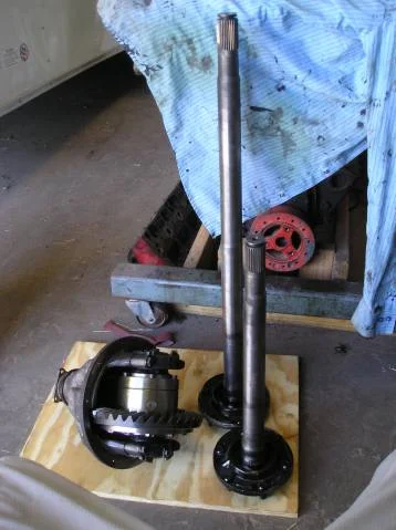

I also completely rebuilt the front and rear axles, all new bearing, seals, etc. I converted the rear to fine spline axle shafts and installed a Detroit locker. The front axle is as is for the next couple years so I can get this thing drivable. Then I’m gonna go to a newer front axle from a later year, and hopefully longs and an ARB or Detroit. But that’s too much to drop into a front end right now.

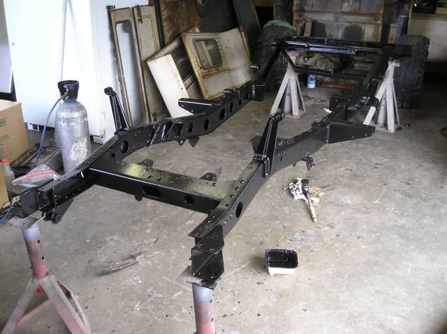

Frame after the POR15 process:
attachment.php
Rear axle goodies:
attachment.php

That's a sseEXXY motor! It's gonna sound sooo good... and the cruiser looks pretty good too. I love those old tops. A friend of mine had one on his 40... we only got it open like twice the whole time he had the thing, but it just looked so cool!
What may I ask are you planning on doing with the AC pump on the serpentine setup? AC? On board air? (I just put a TBI motor in my FJ55, and the GM air is just too big to sqeeze under the hood... dang!!)
