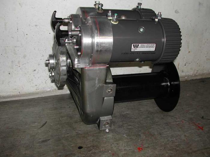

Some pictures from the UK...........
More about the *thing*
Is there something similar known in the US?
Another Twin motor winch from David Bowyer / UK.
Technical Data PDF
But.......3000 British pound....... !

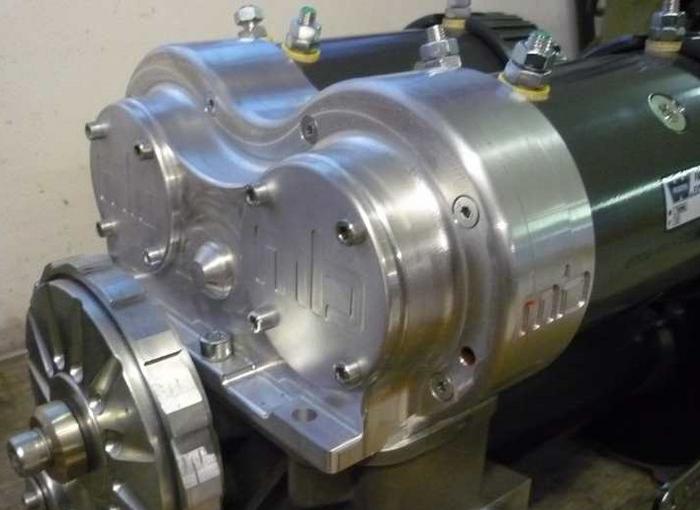

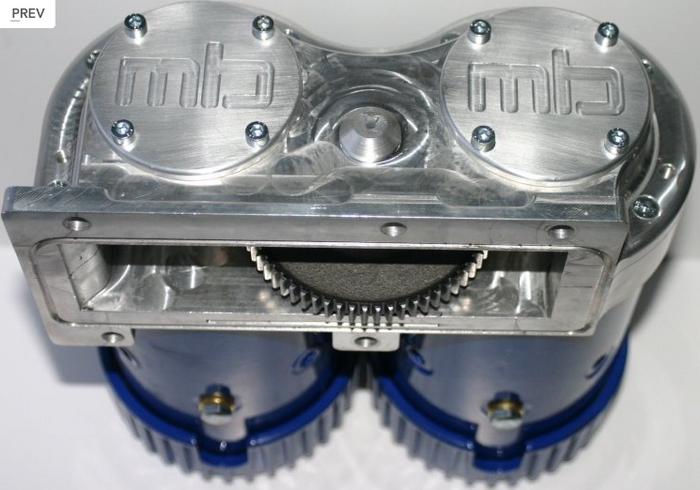

here i will start a tread about my Double Head Winch upgrade for the Warn 8274. Some guys here in Europe and me developing one of the greatest upgrade for the 8274 winch. i thing its one of the best, we and a lot of europeen Offroad teams tested these upgrade for a long time.....
shorts facts:
- two 6,8 Horsepower motors
- complete Heavy duty Gears
- Allow dual head cnc finish
- Heavy duty bearings
- real airpowerd freespool drum
- 30% moore speed as stock
- heavy duty break axle

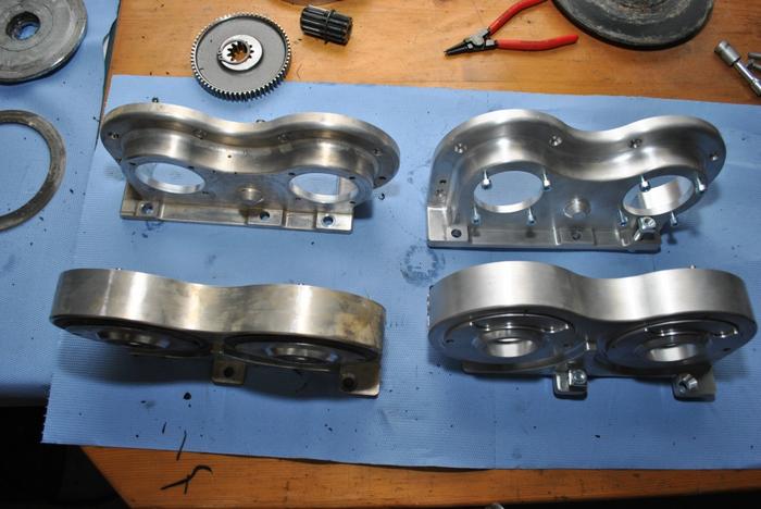

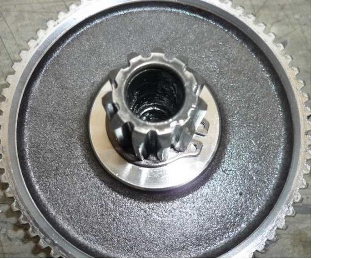

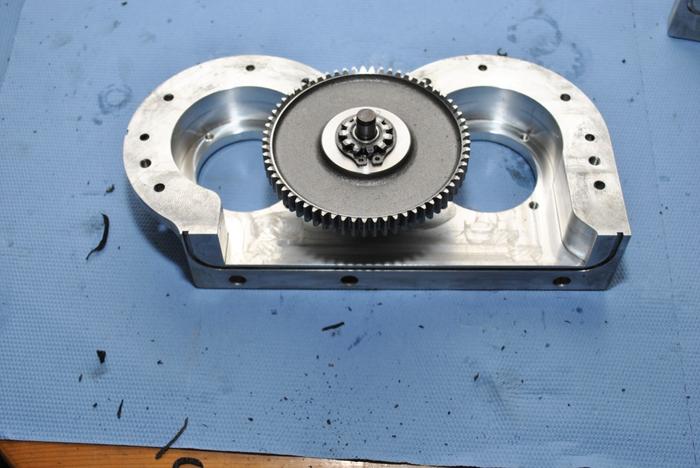

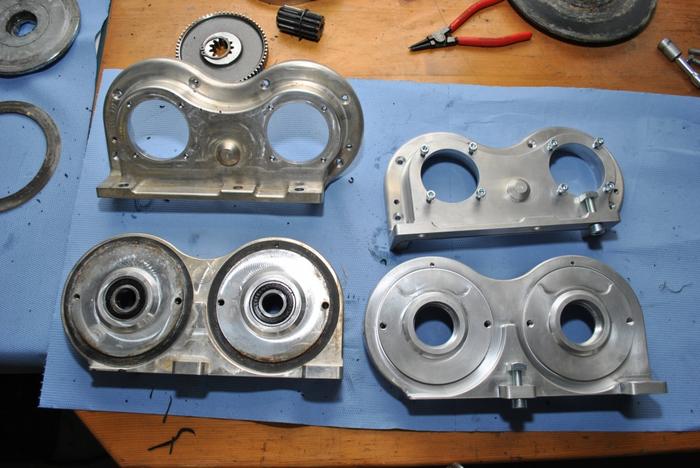

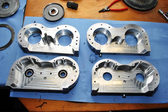

here some picture from the last testing series at the revison to see details after one year using.
the pis show the head, the head on the left side is one year old,
installed on one of our competion cars. on the right side its a brand new
head.
moore pics cooming soon - if anybody have questions so feel free to ask

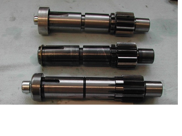

the fist brake axle is our first prototype, the axle in the middle is the stock one and the third is
our new axle type, no dispenable notch bigger heavy duty

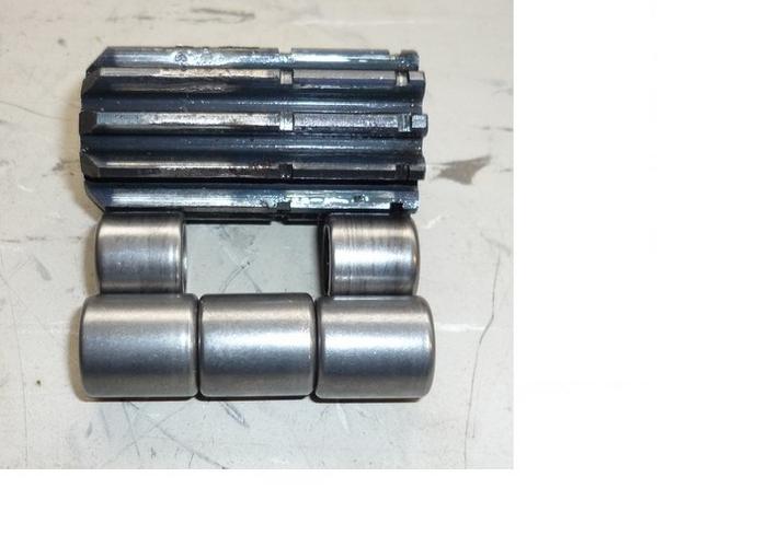

here you see a broken central gear, the reason is the terrible bearing (the both ones in the middle - these small both bearings has no steering ) down you see our 3 bearings
here you see the gear - this is what evey owner of a stock 8274 one time see, a hole without a bearing...
