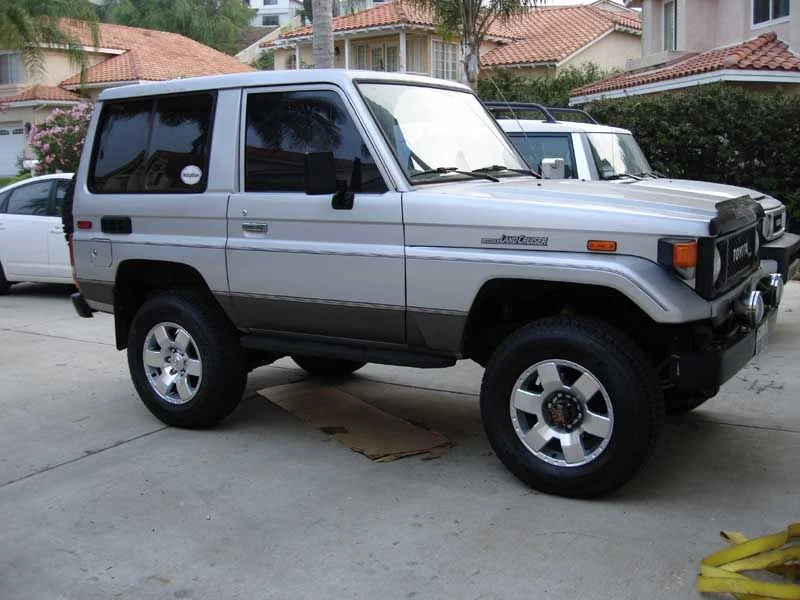

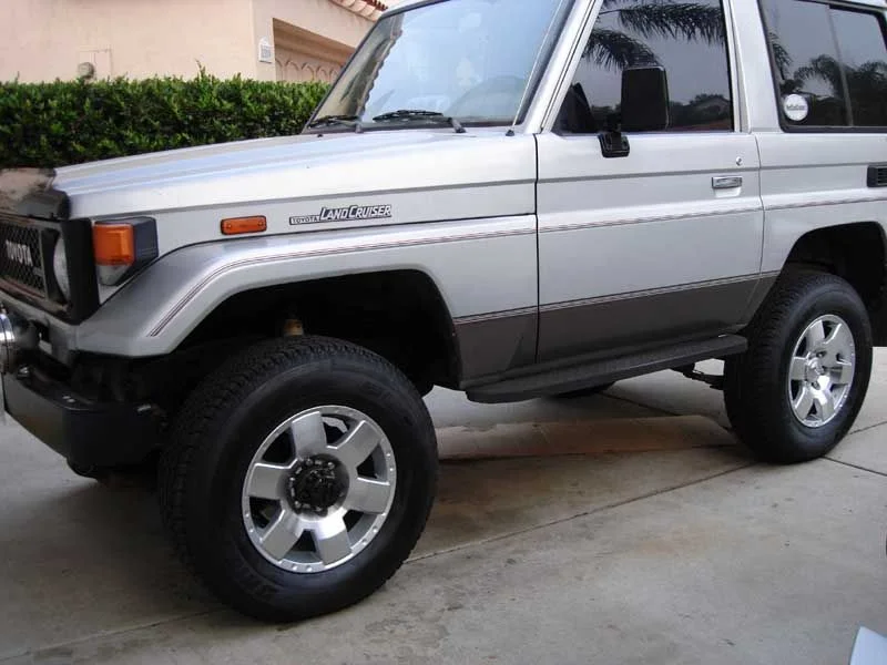

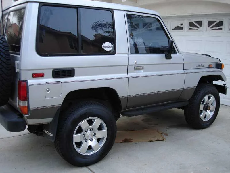

I was looking at my FJ Cruiser wheels that I bought on ebay (pretty cheap) and decided to try these on several different crusiers. From what I calculated before getting them they would fit on 80 series, 7x series, 6x series, and even 4x series. They have a larger back space than is usually allowed on the 4x - 7x however it is a 17" wheel so it clears the tie rod end. I have tried these on my 42 series, 80 series, and 70 series. Here are some pics of them on my 70 series (with stock tires for now). I am planning on using these wheels for my 75 series p/u.
Cheers,
Michael

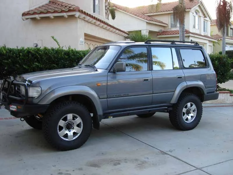

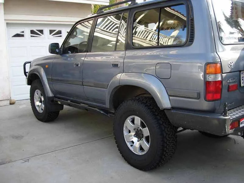

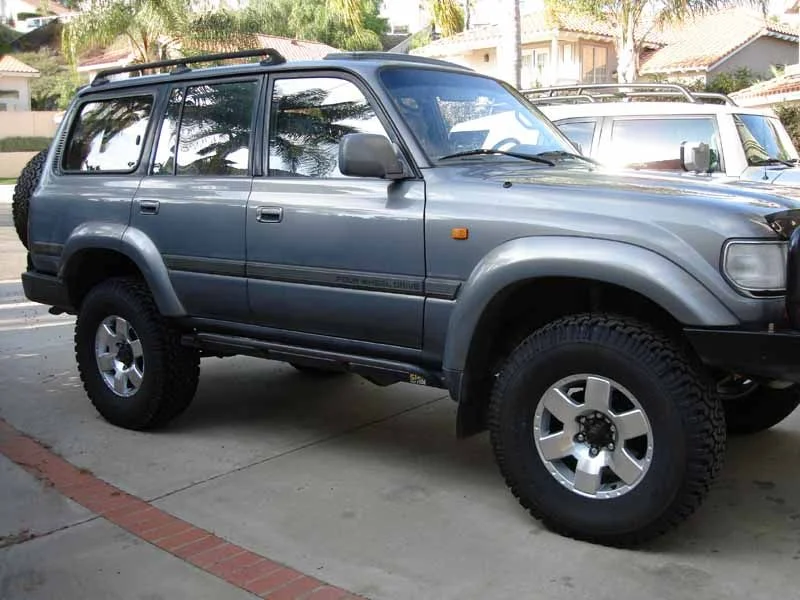

80 series with FJ Wheels and 35" BFG's (HDJ80)
Someone asked to see the FJ wheels on an 80 series so here are some on my 96' HZJ80 with 35" BFG A/T's (no M/T anymore need the better fuel economy).
Cheers,
Michael

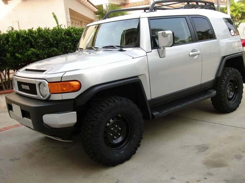

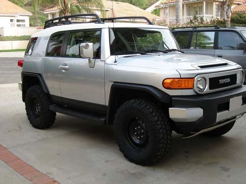

Ok not the alloy factory Toyota wheels but here are some photos of the factory Steel Toyota wheels with TrXus 33" tires on them.
Cheers,
Michael
Not to my taste ,maybe on a jeep they would look ok or painted black.
I like the black rims on the FJ ,gives it some balls;)

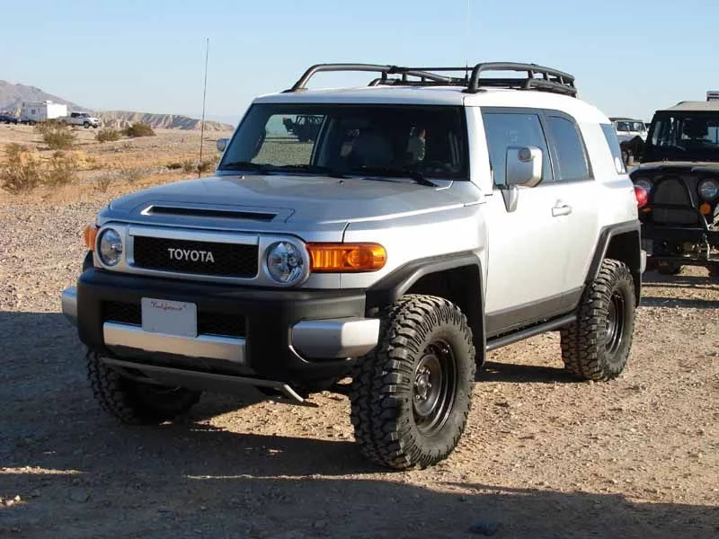

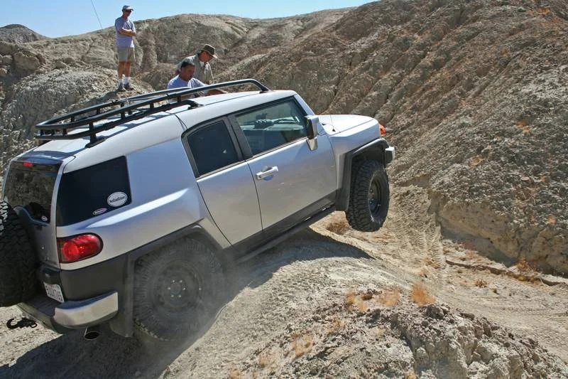

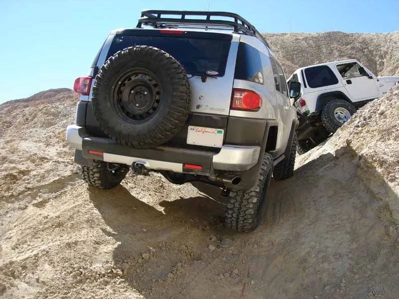

I took it out to Truckhaven to test out my new suspension kits several weeks ago and it did surprisingly better than I thought it would. I was with a bunch of jeep guys (aobut 20) and at first they were telling me stories of how they some one stuck or had to help get one out at one point, but by the end of our run, They told me I made believers out of them :D
I took my FJ to a few places most of the Jeeps did not even want to go. I can say that the way the systems are wired VSC, ABS, A-Trac, Rear Locker in conjuction with Low range is messed up compared to the 100 series. You can not use the A-trac in any other range other than low range, however you canot use it if you are using the rear locker, oh and the ABS stays on in low range unless you turn on the rear locker, the VSC is turned off as soon as you lock it in high range (center diff lock). Needless to say I wheeled with the rear locker on almost all the time, when I tried it with the rear locker off, the ABS usually got in my way of wheeling.
The wheeling I did was very tight canyons with a lot of articulation.
Heres a few photos.
Cheers,
Michael
Wow, these black rims are nice (your FJ, too Michael).
Can you tell me the size of them?
EDIT:
I found the size (7.5x17).
The Tires are 33"x12.5x17 (actual height is 32.5")
