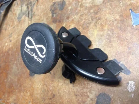

1. Order the InfiniApps Slyde CD Slot Phone Mount. $25 from Amazon

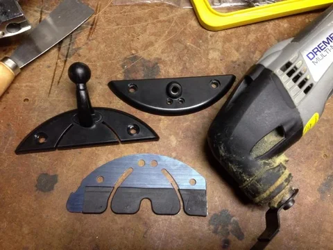

2. Remove the 4 screws to access the rubber-coated steel plate that ordinarily goes into your car's CD slot. Use a Dremel to cut a bit off both ends so that it will fit into the Useless Storage Pocket
3. Here it is, reassembled. In the upper-right corner of the pic, you can see one of the tabs that I cut off.
4. Find some strong material to fill the excess space in the pocket. I sacrificed part of my hitch-mount bike rack's 1-1/4"-to-2" adapter sleeve
