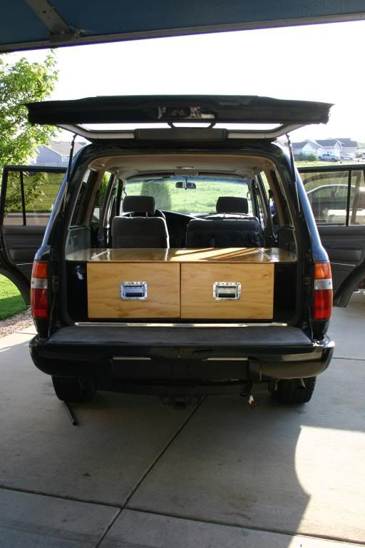

Well, as planned I got everything reassembled last night, and re-installed. Overall I'm really happy with how it came out. It's probably not up to the quality of craftsmanship that the aftermarket manufacturers are able to achieve, but I don't think it's too bad for a guy in his garage working with basic power tools & crappy wood from a lumber mega-mart.
Some final pics:
Color-matched paint:
Cabinet maker, I am not:
(getting the drawer fronts lined up & installed was a beyotch. Anyone have tips for that? Obviously I suck at that part.)
I ordered some Penn-Elcom spring loaded handles for the drawers. SUPER happy with how they turned out.
