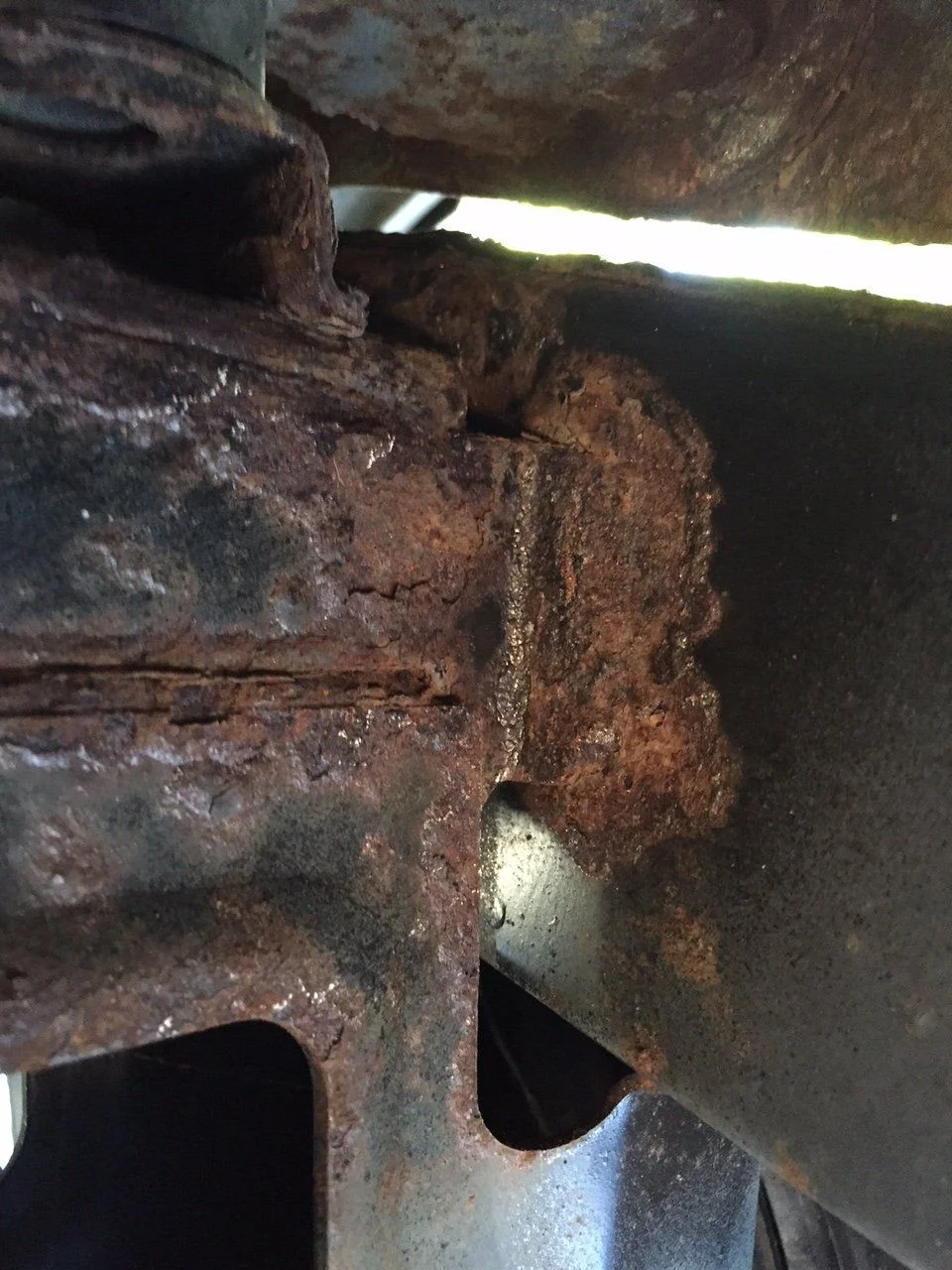

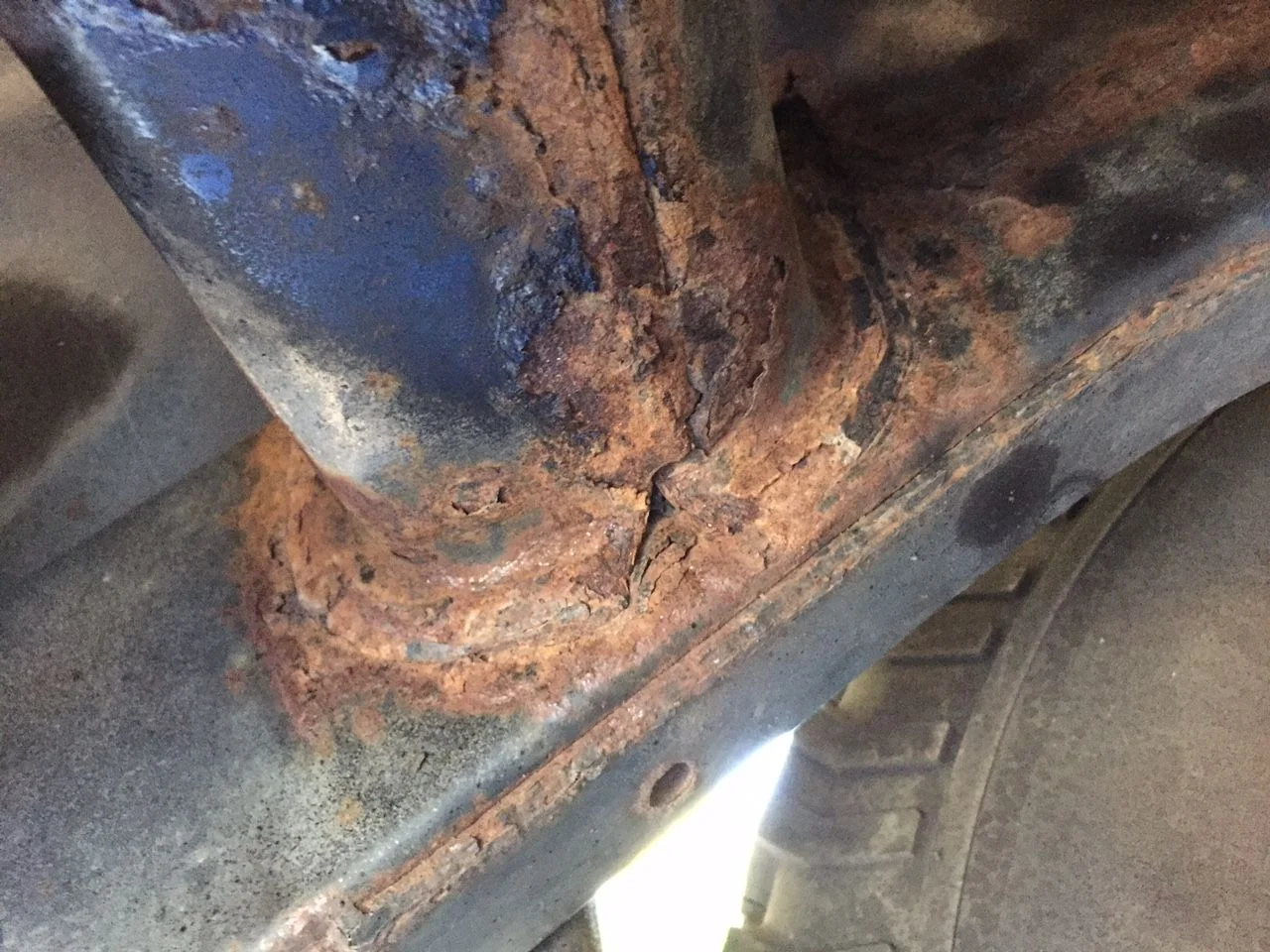

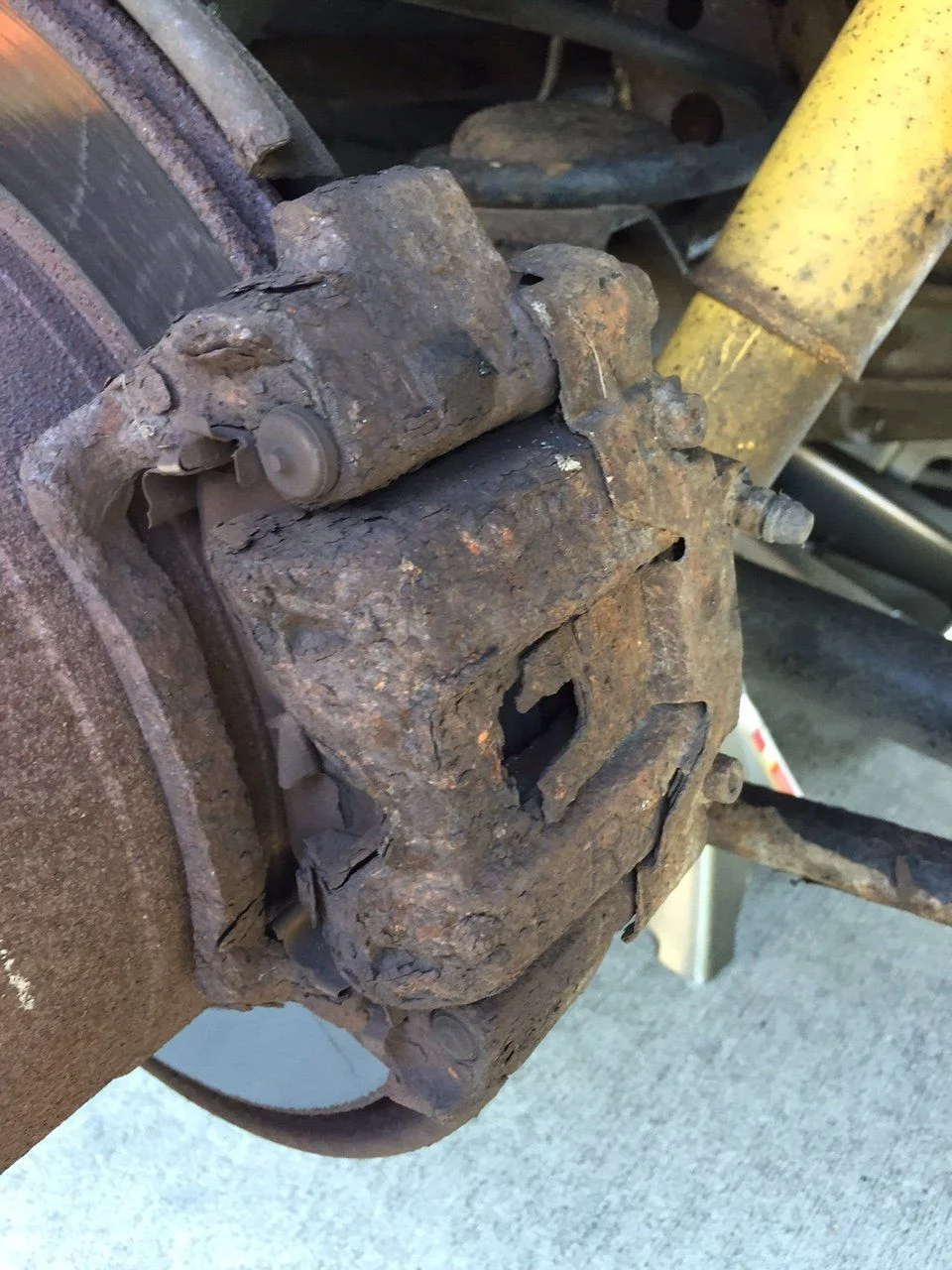

Problem is rust. I saw it prior to purchase. With the exception of a very small spot on base of tailgate glass, no exterior rust is visible in paint. The rig lived in the mountains with the associated snow/sand/salt exposure and there is surface rust on undercarriage and body rust underneath - see photos. I pulled rear wheels last weekend and stopped my brake job when I saw caliper (yes that is a caliper in the pic). Also some visible rust showing up in wheel wells.
Now the question. Being from flaming hot and humid Charleston SC, I don't have much experience with rust on vehicles down here. Once a rig like this has been affected by rust does it tend to continue at a similar rate after the truck has been taken out of that environment? Is this thing going to look like a rusty mess is a couple years or can I expect the process to slow? I could easily cut and run now before I get too attached to this thing and not get hurt $$$ - and look for a replacement but it's such a great looking rig I hate to bail out. All feedback appreciated.

Show some pics of the frame. That's where your real concern should be. I'm not sure how long you plan on holding onto to it, but if the outer body has no visible rust, the rust you showed is only in those areas you posted pics of and the frame is in good shape it will last years as long as you take care of it. Power washing is your friend, and you can also give it the occasional used oil spray down from time to time.

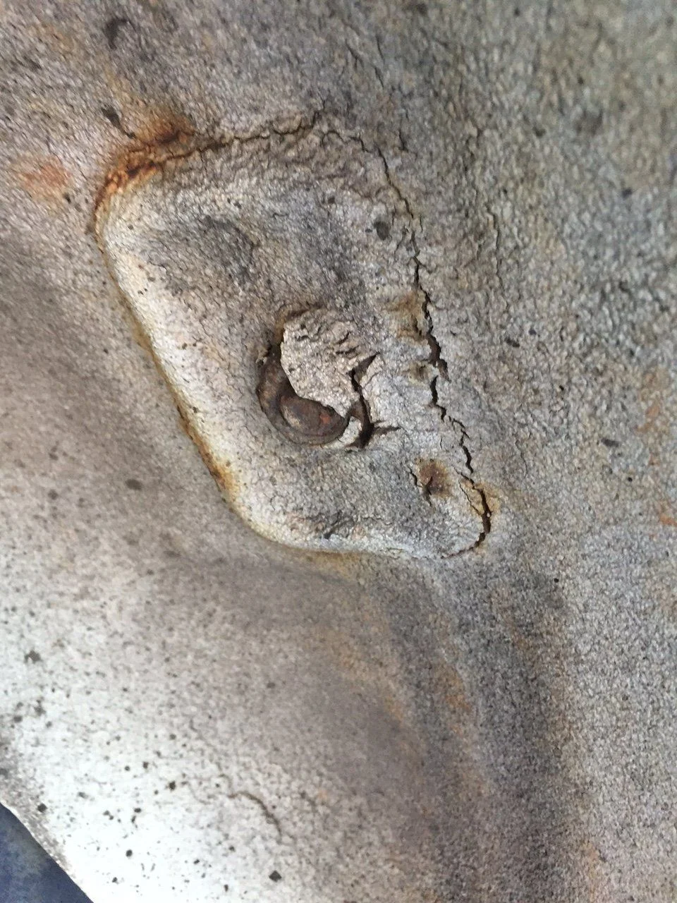

The last pic you posted may raise some concerns, but if it's only concentrated to that area I wouldn't put a FOR SALE sign on the windshield just yet. I've bought plenty of rust free rigs that were plagued with mechanical problems and PO engineering woes.
It is not too bad yet, certainly workable. it will need some rust treatment to stop or slow the rust down. if I have a chance I will bail out and look for another rust free rig.

Thanks for the replies. I will drop spare tire and get in there and take some frame pics and post them. The front of the truck is much better than the rear thanks to the three previously mentioned oil leaks. The oil coated many things underneath over time that probably would have rusted. I am tempted to cash in my chips and look for another mainly because unmolested and "only driven to church on Sunday" rigs seem to be getting harder to come by. That being said, the one I have now is awfully cool so I will see what the consensus is on the frame pics.
So far, with the exception of the caliper, it looks better than my '95. Road salt and the calcium chloride they use now are just brutal on rigs. You kinda expect it up north and it's more common than folks think in some areas in the south too.

That looks like a 1 year old vehicle to me. Maybe 2. Light scale, discoloration, cracking of the undercoat. Not rust IMO. Nothing to be afraid of.
Spend some time with a garden hose and flush out the inside of the frame rails, wheel wells, etc. Allow everything to dry completely. Spray the crap out of the entire underside, frame, all exposed metal, etc. with Fluid Film 2x yearly. Wash and wax the body sheet metal often. If you lean her into a tree and scratch the paint, don't wait to make repairs.

Rust is like cancer, it will keep growing until or unless it is arrested. Merely removing it from the environment where it started will not stop it. Once you start removing the infection you will most likely find more of it hidden "underneath". I once took a wire wheel to an old Datsun B210's door panels and turned (apparently) quarter sized rust holes into 3 inch diameter "clean" holes. After you have removed the deterioration, you need to protect the rest of the metal. I like RustBullet, guaranteed to arrest rust if applied correctly. They're very big in the marine and harsh environment industries. Completely removing all the corrosion is not even necessary, just the "loose" stuff, but I would clean it bare myself.
Well these are about the nastiest shots I could find underneath. I focused on bad areas of frame. I did a bit of brushing under here a couple weeks back but haven't really gotten after it hard. I am concerned about what appears to be that junction for the brake lines in that one pic. Seems pretty bad. If anyone sees anything that really looks like big trouble please raise the code red. Thanks
I've used phosphoric acid with great success. I brush it on and let it air dry. It converts iron oxide into iron phosphate. It is not for you if you need to paint it same or even next day. If you can knock off the flakes and loose stuff then brush it on and come back at it next week it will do the job. It won't free rusted bolts. I haven't used this on my 80 yet but I am about to. I'll post before/after if anyone would like to see.
It may not look all that bad, but you can't tell what is underneath. I now live in Texas (and won't buy ANY vehicle that was up north, PERIOD) but grew up in the northeast. Once you start removing the tooth decay you will be surprised how deep it is. If it were me I would wire wheel/grind it all off to bare metal and arrest it with proven protection, otherwise be prepared to revisit the problem again soon. Unless of course you plan to sell it within a couple years to some poor unsuspecting buyer. Paint and even the corroded metal surface will hide how bad the infection is.
