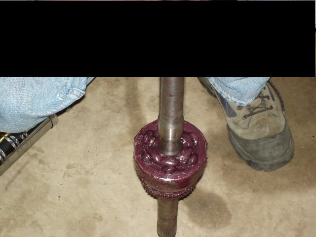

If i remember it was three tubes per side, now, I purchased eight tubes total and "used" all of them through the job, but I really grease up good, there was some leftover in my pneumatic grease gun and there was some leftover in my bearing grease tool, so figure three tubes per side, one tube for bearings and the extra is left in your gun ...
First.
Then ...
