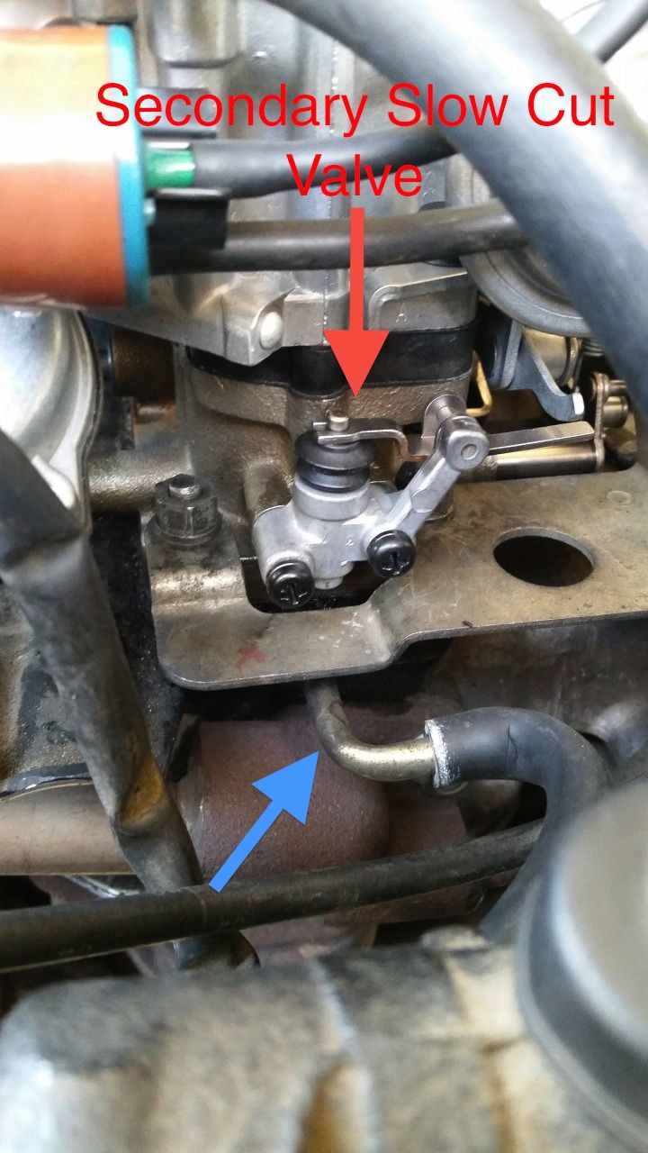

The wetness is most likely a result from the Secondary Slow Cut Valve assembly (see image below). It is a non-serviceable part (can't get new OEM anymore, and can't be rebuilt because the valve itself, overtime, wears down and the tolerance between the valve and the housing wears, causing a gap and allowing gasoline to leak out). But you can pluck the valve from the housing, tap the hole in the housing and then thread in a bolt with some JB Weld on the threads to permanently hold the bolt in place. see this thread for more information or search 'Secondary Slow Cut Valve' in the 60's section for more specifics on the modification:
https://forum.ih8mud.com/threads/newly-built-carb-fuel-leak.850428/#post-9694055
Also, does the pipe that the blue arrow in the image twist/move? I've never seen that pipe outlet pointing to the side like that...I've only ever seen it curve and point upwards....

On second look, that Secondary Slow Cut valve assembly looks rather newish (at least the screw do...). Have you contacted the folks who rebuilt the carb and tried to do any troubleshooting directly with them? Might be a good idea, too...

Also - I clicked the link and didnt notice a blue arrow anywhere on the image....

As I was placing the carb back on I noticed the "insulator plate" (as I was told it was called by Specter) where that BLUE arrow mentioned in a prior post was - had worn down completely where the metal pipe meets the plate. Luckily my local junk yard pulled an exact match from a similar model and I replaced it ($50).

That pipe that curves up and out through the body of the insulator is a vac pipe. If there are cracks in the body of the insulator around that pipe, then it will be a significant source for a vac leak. If you wiggle that pipe a bit (don't put too much pressure on it) and it moves about within the insulator body, then you probably need a new insulator (also still available new from Toyota ~US$150).
When dettatching/attaching that hose that connects to that vac pipe, be mindful not to put too much pressure on the pipe, otherwise you might crack the insulator material around it (if the insulator is old and has seen a lot of heat).
Your US$50 used insulator should be good as long as the top and bottom surfaces are flat (not warped) and the pipe is still secure in the insulator body with no cracks.
