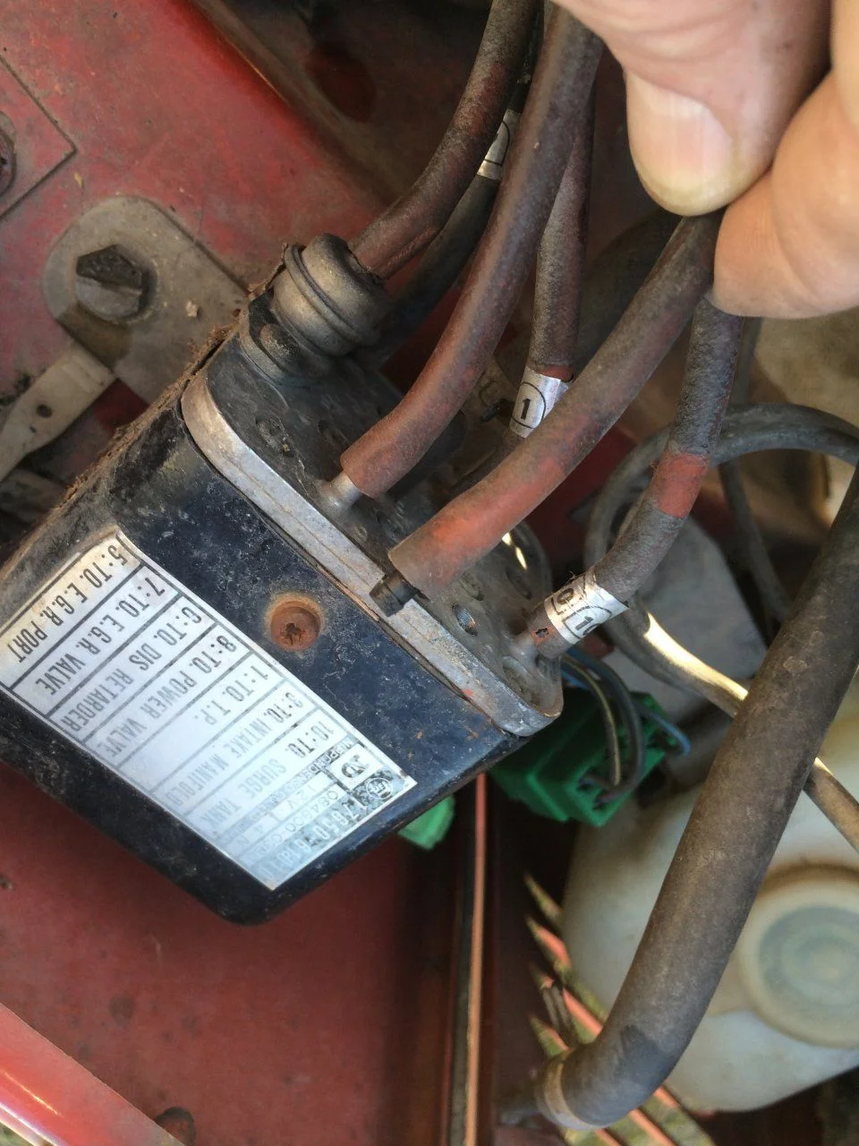

OK, I think the problem is solved. Lambcrusher and Pinhead both sent me in the right directions and the 40 now runs beautifully with the barleywine cork removed and the hoses from the air pump through the ABV all hooked up correctly. Excellent engine response and idle and no backfire of any kind on deceleration or shifting.
Solution:
1. Found no vacuum in the line from the VSV to the ABV. In addition, the line from the VSV to the BVSV blue had 18 in. vacuum. No vacuum at ABV meant no diaphragm actuation to redulce air flow to air intake manifold upon deceleration. I think this caused the original problem, although I don't know why this has never been a problem in the last five years I have owned the truck.:hhmm:
2. Several other ports on the VSV were connected incorrectly. I recorded and drew what the original setup looked like.
3. I replaced the missing throttle positioner screw. Removed the vacuum hose from the TP diaphragm and noted movement indidating it still works. Reset the TP screw per FS emissions manual.
4. Removed the hoses from the VSV and re-routed all to the FSM diagram.
5. Removed the barleywine cork from the hose to the AI manifold, reconnected this hose to the ABV air output side, and put air cleaner back on.
6. Test drive the truck through the local hills and it drives and sounds wonderful! Tomorrow I'll take it to the smog station and test the HC and CO and see if the CO has come down!
I hope this is useful to someone else who encounters this problem. I truly appreciate the attention and guidance given by Lambcrusher and Pinhead.
Excellent thread. I was in similar boat, just adjusted valves and timing and the world went to pot. Rather than re check my work for the third time saw this post and redirected my efforts . Found this broken link from the intake. My last 40 was smog free so this is all new to me
