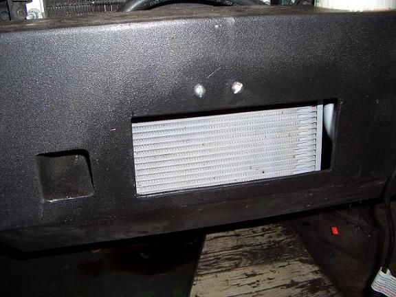

put oil cooler in bumper

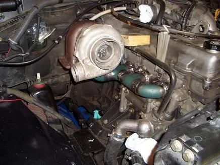

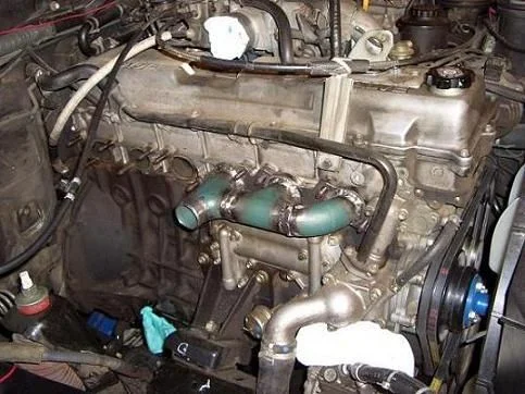

turbo is used to4e 46 trim 70 ar intake w 83 ar exhaust-i took it apart and it looks good-is a rebuild garrett. oil feed only (no h20).

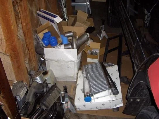

external wastegate and intercooler are xstreme ebay knock off stuff-hope they hold
stainless oil feed and return lines
intercooler ducting is all aluminized exhaust tube-old school
the silicone tube couplers aint cheap
I dont know where ac will go yet-have a guy who will make a custm ac line but he wisely said to come back after the turbo is in

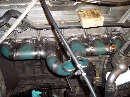

Where did you get the s/s elbows?

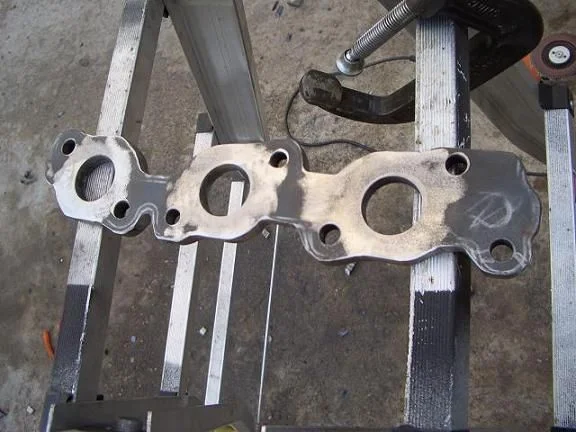

If you can make a 2nd exhaust flange I would be interested.

Got some more done

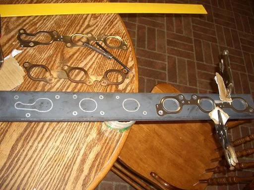

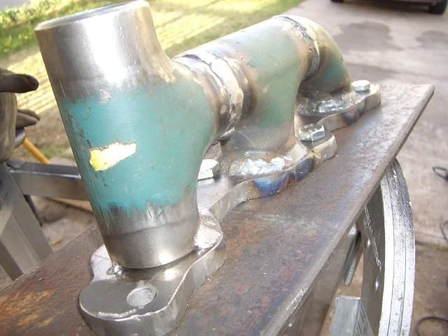

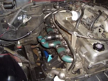

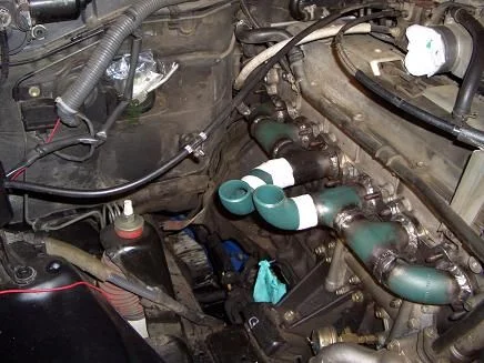

GNK--the weld els are plain sc40 "WELDBEND" and I got them at the local commercial plumbing supply. (they are 1.5" ID) They are not cheap-each "T" was $22. The elbows were only $7 each. They weld up nice (with careful prep). As you probably suspect that flange was a bitch. I'd be willing to make more for cash but you probably dont want to pay what it would cost to get me to do that again. All you do is trace the gasket, punch holes with a 1 3/8 hole saw, and grind like hell. Note that I still need to take my air die grinder to the exhaust holes and shape them to the block holes (the hole saw makes a round hole but the exhaust comming out the block is oblong) Ill show pics when I get there
