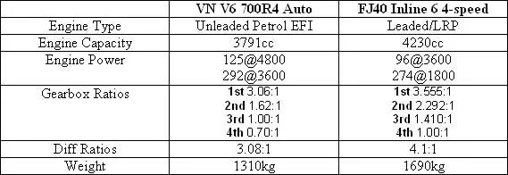

Here are the specs: (see attached picture)

agreed.... that v6'll struggle with cruiser weight. their not the torquiest buggers...
just LPG your 2f and be done with it... don't believe all you read about valve stem failure due to no lead.... lead was removed from american petrols ages ago, and most these guys haven't had major problems with it...
see where your torque is made in the v6, see where the 2f torque is made? save the money you'd spend on getting it, the adaptors and the headaches of wiring in the computer etc, and the engineers certificuits. and live with the 2f... on gas they don't hurt too bad.

the way i look at it, the v6 will cost you about 800, the converter for the auto-transfer case = more $$$ engineering certificuit = probably 300, then getting the ecu to run in the 40 is more time or $$$ and you'll end up underpowered in my opinion... not to mention the things like driveshaft length modifications, adapting cooling/ charging systems, potential oil pan clearance issues, and the like
so if you save that money, and use it to fix the 2f if any problems arise from using premium unleaded without additive your still ahead for years... convert the 2f to LPG and you still will have savings (plus savings from fuel...).... you can pick up a running 2f from a wrecker for under 1000 and that will drop straight in in worst case scenarios...
