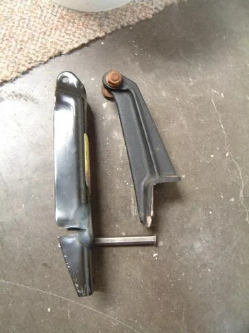

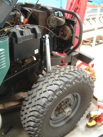

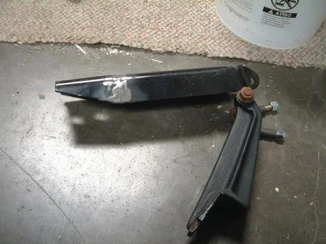

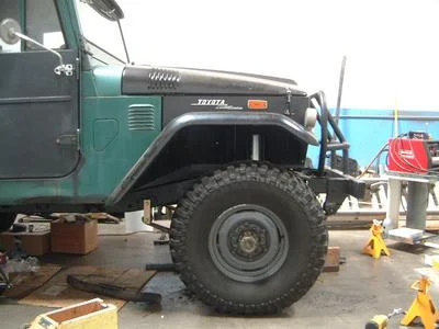

After straightening my Ftowers, I was able to weld them onto the frame with practically NO trimming of the inner fj fenders.
The Drivers-side required 1/2"
manny 72fj40
filled in w/welder :D
bilstein 12" 5125's
passenger side
detail on towers:
Ford Shock - Bracket Upper - F250, 4wd 1987 - 1991
Item Number MSRP Price
E5TZ18183A $13.15 $10.52
Available online if you don't have a local ford dealer:
http://varsitylincmerc.com/parts.html#

Sorry for the delay...but here are the pics.
hny,
manny
full right:
straight:
full left:

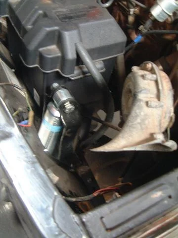

as you can see about 1/4 inch of trimming was necessary on inner fender:
notice, passenger side inner-fender did not need ANY trimming:
