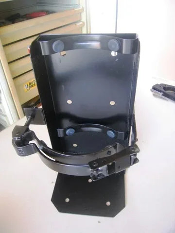

The bracket is a basic fire extinguisher bracket that can be bought at any fire supply house. I'll probably get one to fit my fire extinguisher, order up some more roll bar brackets and mount it on the oppossite side of my CO2 tank installation. It's strong, it works, and with a huge flat side is pretty easy to mount.
The only thing lacking is a locking mechanism. I'll probably end up fabbing something up myself.

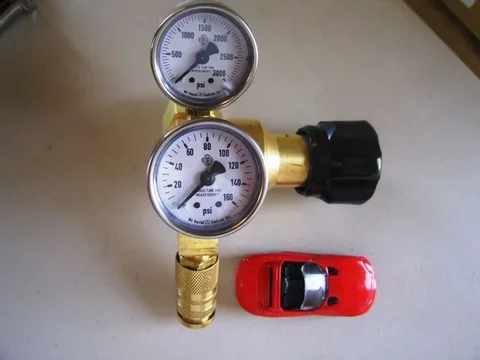

Now for the part that pushed my decision over the edge; the regulator. I have to say I'm impressed with the design of the regulator. It appears to be very well built and with it's angled design, is very compact. I have always questioned the need for two guages on a CO2 system. I would rather have just the regulated pressure guage. The other is worthless IMHO. That said, the design keeps the guages out of the way as much as possible. The angle design keeps everything nice and compact, even when the hose is attached.

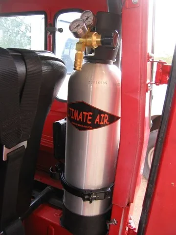

The rear tub of an FJ40 has a lot of flat spots for mounting a tank. I knew I didn't want to mount the tank on the floor though as this wastes a lot of space in my opinion. I have a family cage by manafre and decided the best place to mount was in the back corner of the vehicle off the roll bar.

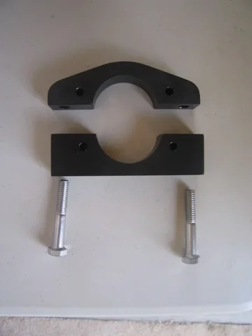

To do this, I ordered a set of roll bar clamps. The only thing missing is some washers to spread the load. Probably not needed, but can't hurt. The clamps work great. They are designed to match up with the predrilled holes in the bracket. Because my back pillar takes a small bend, i had to drill a couple new holes for one of the brackets.
I'll probably be ordering more of these brackes for other fabrication things I have in mind. Again, they are very well made. They come in different sizes for different tube diameters.
I wanted as much capacity as I could and still be able to fit the system on top of my rear fender and still have everything under the roll bar. I was worried the 15# system would be too big but it fits like a charm. Enough for tonight. Tommorrow I'll post the install pics.

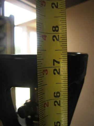

Here's the height of the 15# tank FYI. Hows that for a picture not needed!

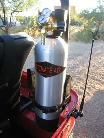

There's not a whole lot to say about the installation pictures. I'm just going to post some that show how the tank fits with and without the top on. I am really pleased at how the tank fits. It's a great use of space in my opinion.
You will also see that I used the front of the bracket to mount a quick release bracket for my FT-8900 Ham radio. Again, taking advantage of space that is otherwise pretty much unusable.

This is a K400 Diamond lip mount. As you can see from the other pics, it works great with and without the top installed. I am going to add a strap to help with grounding soon.

Well, not super technical but hope it gives you some ideas. I will be making a shield out of sheet metal that I will weld to the rollbar to protect the radio when the top is off. As it is now, the radio and the antenna connection could easily be damaged by trees, brush, etc.

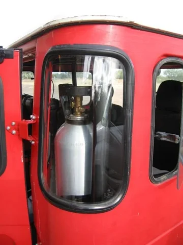

Here's what you see through the rear corner window. The funny thing is I've had three people ask me why I added nitrous! :)
