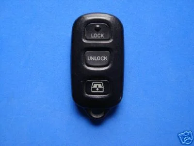

I have been reading all these treads as I just bought a 98. I also just have the regular key. But instead of the transponder key, I would rather have a key fob keyless entry. Is this possible?
Like this

Probably not, but compare FCC IDs on the back, maybe they have the same frequency...
