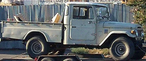

The first stage for my project was started yesturday when I brought home the truck. It even ran and I did not fall through the floor like I first thought when I saw it for the first time. I will now try to post a shot of it here.truck 003.1low[img]

Sorry for not replying to your replys sooner but it seems that I can not get my letters to get posted most of the time. Oh well just another one of my chalinges I gues. Thanks for the other sights to go to and read up on. Can the parking break mounted on the t-case be transferd from one t-case to another or is the shaft comming out the back of the case bult with a non removable flange so depending on what t-case one has will deturmin if it will have this type of break or not?
