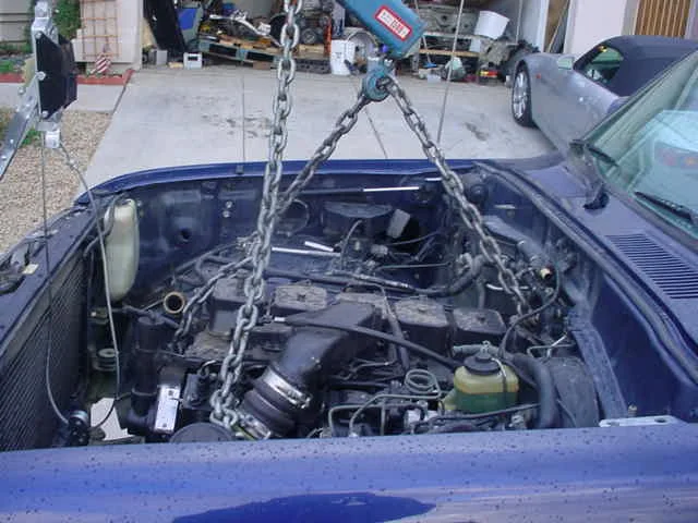

Well, It took me long enough to get this far.. Ive spent 3 weekends prepairing for the drop. With in 6 days I was able to install my 3" body lift, remove the engine, transmission, transfercase, and anything else I didnt need. I also had to strip the inside for ease of body lift installation.
A lot of people thought that it couldent be done, and that it would be to heavy, but its no heaver up front than some rigs with 300lbs of bumpers, batteries, and a winch.
What I have is a 1996 FZJ80, 6" slee lift, 3" body lift and 37" Krawlers. The Cummins is out of a 1996 Dodge ram 3500. being that it was mated to a manual transmission and not an auto, the engine produces 215hp and 440ft-lb of torque. http://dodgeram.org/tech/dsl/Facts/96specs.html
The transmission I will be using will be the dodge 47RE 4 speed. Right now that will be enough untill I can afford to drop the trany and get her made billet proof.
As far as the transfer case, I am hoping for the Atlas 4speed.
In the mean time, Ill post a few picts. I have more, but they need to get developed. So heres a few with a digi my friend let me borrow.
I also have a few picts here as well. http://forum.ih8mud.com/az-copper-state-cruisers/81202-3-bodylift-diesel-install.html

VERY COOL SWAP!!!!! Looks to me like the you did not really need the body lift. Did you do it so the trans would clear the hump? lloks like you will als be able to fit a mechanical fan & an intercooler in thier also...
Why not a 205 case? I believe they will work behind the 47R's & will be more than enough gearing for the 80.
keep us up to date cause I would love to do this swap but $$$ & time are really limiting me.

Well, Unfortuantally, being that I have a off centered Diff.. and my new setup requires a centered diff.. I need new axles... Ive been looking at the portal-tek axles. Anyone have a set of these under their rig? THey look like they will more than hold up to the weight and power of the Cummins. I went with a body lift because the engine was 3" taller and the air intake is about 5" taller, so I thought I would need the extra lift.. It doesent look like it... but it does help alittle with bell housing. Isint the 205 case a drivers side drop though? I need a passenge side drop.

I think the portal's will give you too much lift (about 6-7") on top of your 6" lift already & if you removed your 6" lift you might have axle interference with the oil pan. You should be able to get your measurements now to see if that would work.
The 205 is passenger drop in Dodge Cummins 1st gen & you could get a set of axles off of a dodge & have them cut down for way less than a set of portals and have a higher load carring capacity. I have not investigated this much, but its what I've picked up off of the TDR.
It all depends on how you plan on wheeling it wether the portals would be worth it.
Are you planning on a custom innercooler or will you be able to get the stock one to fit?
Keep us up to date and be sure & throw some more pics our way!!

Yeah.. an extra 4" of axel lift + 6" suspension + 3" body lift .. will put me too high, I would like to keep te body lift, Because that will allow me to get a larger fuel tank, route the larger exhaust, and it will make it easyer to clean the mud from inbetween the body and frame. I donno... Ill have to see what it looks like. If I can get away with out the body lift though.. I think Ill go with that. Ill just push the axles out an inch on each side for a little more stability.
If the 205 case is a passenger drop, that might be something to look into, becase the Atlas is about 2800, and I could probably get a 205 for under 1000. alough with the Atlas 4-speed, ill have the gearing for any type of wheeling, 1.1 for the dirt, 2.7 for sand, 3.8 for mud and 10.1 for the rocks.
As far as the axles go, the portals should hold up much better with the added weight and torque of the cummins.. This way I can boost the power from 215hp and 440ft-lbs to somewhere inbetween 300-500hp and 800-1000 ft-lbs, and not have to worry about terring the toy axel to peices.
I will be getting a custom radiator that will have electric fans, probably duel fans, I dont know if I will have them pullers or pushers, but it will give me about 6" more space up front with the engine mounted fan not being there. That will give me the space upfront for the intercooler. Ill probably go custom as to get better flow than a stock unit.
