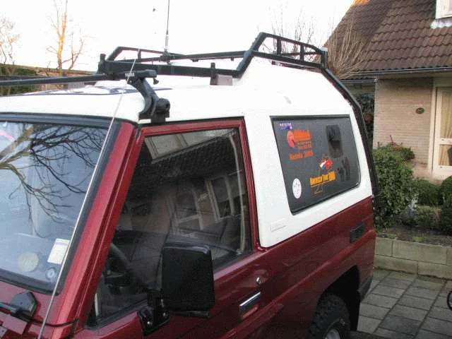

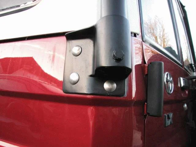

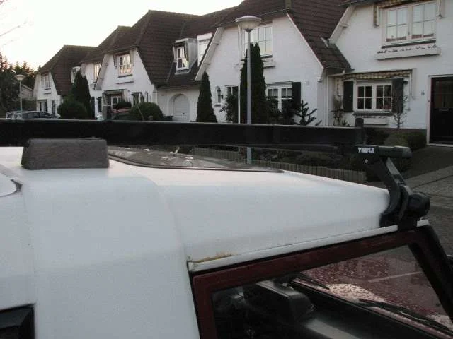

Quote:
Originally Posted by roscoFJ73 View Post
The top is removeable,FRP is for fibre reinforced placstic. However its not something you remove and replace in seconds when the weather turns foul.
You also need cut down doors or ones from the rare soft top model that have the removeable half doors.
Gold boys roof rack is one way. The other way is to secure it at the front like a nomal roof rack and use alloy bars bolted to the rear bumper to support the back end.
Others have drilled in the FRP but I predict these holes will elongate over time or much more quickly when you are offroad or in an accident.
I agree on all your remarks Rosco.
Especially about drilling in the FRP-top. I did it that way as well. The wall thickness is minimal. Most of the sides are double walled and that complicates the matter.
Then, the FRP is not up to the forces that act on it. I took the rack off the moment I discovered that cracks were developing in the topcorners of the backdoor openings.
All I used to have on there was I kind of integrated Aluminum fuel tank of about 50 liters. The roofrack/fueltank was bolted to the FRP-top and had large "flaps" that formed the studs on the roof so as to spread the weight.
I now have a completely different setup. See photos below.
The rear attachpoints have backing plates in the same shape. This way the stress is spread over a large area.
It has been on there for more than 35.000 km now, 15000 on a trip to Kazakhstan under very poor conditions and two desert trips totalling about 12000 kms.
During my last trip I had an accident (nose dived into a ditch), strapped gear in the back flew around, my glasses ended upon the dash-board! The roofrack still in place, no damage. I have to admit the roofrack was empty (just the antennas) but I've seen roofracks completely thrown of a rig under similar conditions.

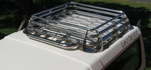

this is my roof rack made from stainless steel, it even has spot light mounts at the front, any half decent fabrication shop will be able to build you one to suit your needs
Wow, stainless steel. How heavy is that?
Can hardly believe it's just sitting on top of the FRP.
Many of the roofracks I've seen in combination with FRP-tops were effectively sitting on top of a construction underneath the top. Most of the time with bolts through the top as to fix the rack to the construction.
Everyone I've ever spoken to who had a roofrack sitting directly on the FRP-top was complaining about cracks developing.

Quote:
the rack is bolted to 5inch wide stainless steel plate underneath so no cracks and silicon on both sides so it does not leak
