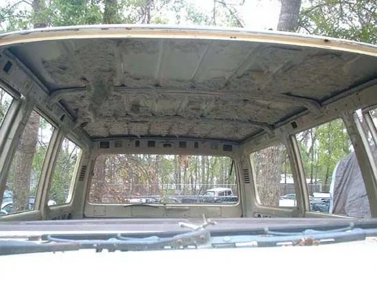

Roof Liner
Hey LowTide,
I've taken my headliner out of my cruiser and that insulation is glued to the roof. It may not be too hard to remove if you do it rightm but from my experience the insulation just rips when you try to pull it out. I haven't done anything with it lately but the pic I will attatch will show you what I mean. This picture is taken from the hood looking back into the truck. I can get more pictures later if you want any.
Caleb

i wonder what those square holes are for? were the non-us models equiped with extra interior lights or something??

Putty knife time...

A wire wheel works well for removing left over insulation from the roof.

I like the look of my two-tone stock grey interior. I'd just remove the insulation and pop in a new, or cleaned headliner. The bare metal would look kinda like a Ford Econoline van, so I don't think I'd do it, but I need to see one to make a final decision.

It looks like a biotch to remove. My headliner is in bad shape as well. I was thinking the same thing about removing it. What do you do about the material around the windows and down the side rails!!

That insulation sucks...my crusier sits in the summer sun for an hour and its like a blast furnace radiating from the headliner.

3 putt get a full roof rack. mine has the mess floor and it throws a shadow on the truck. It's kinda like bringing along your own shade.

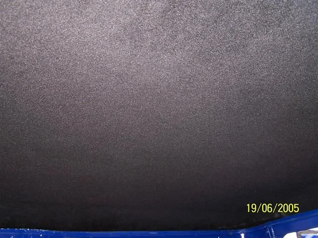

I saw this foam used to replace the liner on a BJ40.
Its a sound deadening foam and the dark colour makes it almost unnoticeable.
I suppose it glued into place.

Might suck a lot worse in FLA with no insulation at all.
For the headliner fabric along the "A, B, C and D" pillars, remove the pressed on rubber trim that goes around each door opening, there are a few small metal clips you can remove with a flat-head screwdriver or vise grips. The headliner fabric is held in place with adhesive in addition the the other stuff, peel up and edge of the fabric a tear it away. Where fabric runs up to windows the headliner fabric is tucked up under the gaskets and glued to the pinchwelds (the lip that the gaskets sit upon); you can just pull the fabric out from under the gasket, but you probably won't get it all. The bows (metal rods that go across the roof under the headliner supporting it) can be easy removed after the edges of the headliner are free and that's about it.
