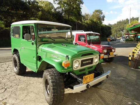

Doing frame off restoration under my gringo supervision. Have contracted with a local body man and mechanic with over 20 years experience with these vehicles.
I am attempting to do something a little different:
1. prove that Colombia is a good source for clean classic FJs
2. prove the quality of workmanship in Colombia
3. by doing the above be able to ship interesting, completed high quality FJs into the USA for resale
Just took him the car today. He knows ALOT about these vehicles although obviously there are some differences between the Colombian spec models and the USA models.
I found a 681 original green 1983 FJ40 with factory metal hardtop (rare in Colombia). They were used in this color by the local government utility that installed water/gas/electric/internet in the city. The govt utility has a reputation for thorough fleet maintenance. They are currently running the 2 door 70 series landcruisers now.
We are doing full frame off restoration. Truck is in generally good condition. The motor is very strong and the transmission shifts a little rough but could be just my perspective. No frame damage. No bondo and very little rust.
Has some rust in the left front footwell. We are replacing with factory style panel which is fabricated down here. There was little or no rust in the rear tub floor area but we are replacing it bec it was dented up from its use as a utility vehicle.
I have questions regarding the restoration details will post in the following posts.
