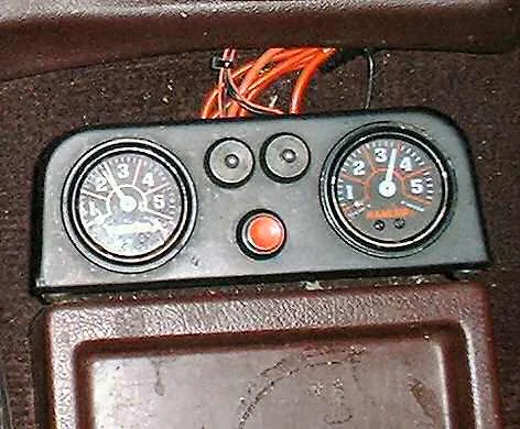

in-cab controller - I put the in-cab controller next to my CB where there just happened to be perfect space. under the dash and out of the way so that all of the air hoses and wiring can be hidden (as there is a LOT coming into that controller).

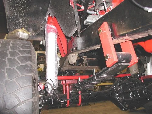

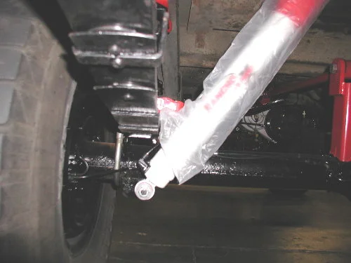

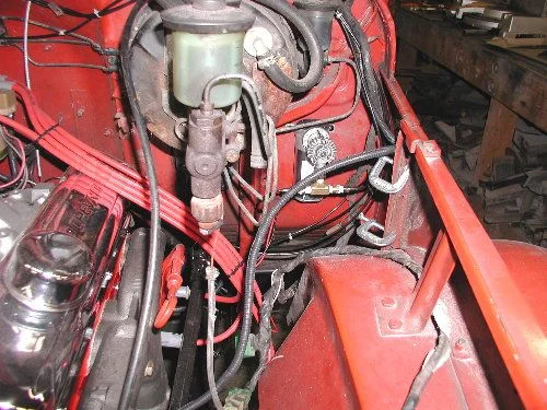

I did pay full discounted price for this set-up and I love it!. Haven't taken it wheelin' yet. I love the soft ride on #1 setting and rarely pump it up, but I do for curvy high speed driving. The convenience factor was the seller for me.
I zip tied the lines to the brake hoses and sleeved the lines with rubber hose where it enters & exits the frame rails.

nice install on the firewall. I also sleeved the lines to protect them at critical rub potential spots as it is pretty stout tubing.
are those shock condoms?

I'll tell you right now, lose the boots! What finally took out my shocks was RUST under the boots! It took 5 years but they rusted all the way through and started leaking fluid right where the zip tie was and became worthless.
They have changed the pump since I bought mine for my Pathfinder. My pump is encased in a nice plastic box. That pump looks a little more heavy duty.
