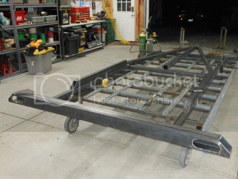

Well Folks, the new build has begun, and once again I have the honor of bringing you the first pics. But first a short word from our intrepid builder...
"This is production trailer number 1. Some major changes in the frame. The first one was extremely strong, but had some rough points for me. This is smoother and stronger. 2 inches longer, which will allow for a small bumper in the back. Water tanks farther forward. It may be just a little heavier, but I never want to see a broken frame." - Skersfan
05/13 from the Blue Room... "All of my trailers are built on a jig. You are looking at the frame on the jig. I sent Old Sarge some off the jig. Tomorrow pick up the top bows being bent by All Pro, hope to have the walls on it by tomorrow nite with luck, if not will be shut down until after Overland Expo, as the prototype has been put through the paces for the last 8-9 months so she needs a good cleaning, touching up of the scratches, to make her presentable." - Skersfan
As you can see this started several weeks ago, so we've already got a good run of pictures. More to come shortly...:beer:
I just weighed the frame with 35's torsion axle and spare carrier. It weighed in at 1040 pounds. I am guessing the trailer will weigh between 2300 and 2500 complete. This will be heavier than the prototype. Sarge is taking this thing to Alaska, solo so I need to know it will make it without question. Due to the design with the water above the axles, the battery 159 pounds of it all right over the axle and the snubbed front end it tows much easier than you would think.
My prototype is right at 2200 pounds, but I get better mileage with it than I did with my tent box trailer and it tows better, due wind turbulance being less.
