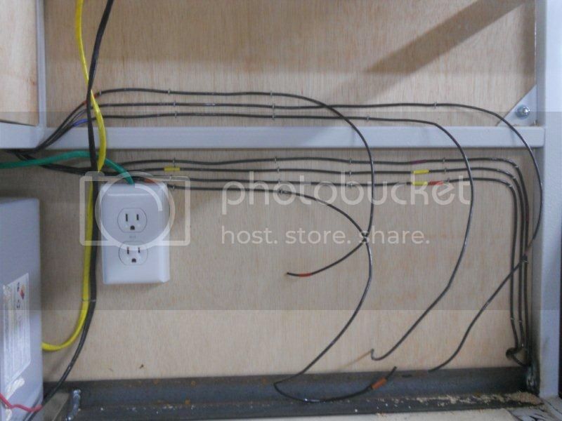

From late Friday, 06/15 - After checking everything out, the original position of the stove top was correct, but I moved it back an inch and in from the wall another inch. I feel better about it anyway. Sink and faucet are in, the stove is set but not screwed down. I have worked on the inset boards and have them all cut. Will need to stain them yet. Worked on the 12 volt system, almost all wires are looped and ready to run to site. Each one is color coded. All are crimped, soldered and shrink wrapped.
Will finish up the wiring of the 12-volt prep in the morning, I have two more wires to prepare. Then I'll run the 110VAC and the wiring to the fridge, the TV, the AC/Heat unit, two outdoor light fixtures and three interior light fixtures, and I will run the inverters directly off the solar system. The solar controller will also get installed tomorrow. Try to build the header system for the water systems and install the water pump and the hoses from under the trailer. May try to attach outer skin to the rear door, will cut side doors out and finish interior painting. Sunday I hope to cover the top and seal it up for fiberglass early in the week - Bob

Electrical is coming along nicely. One plug is for the fridge (on its on fuse). As a matter of fact the water pump, interior lights, outside lights, tent light, and hot water heater are all on their own fuses. The 110VAC system will have a breaker for each piece of equipment. All the wiring so far is under the counter, trying to keep all wires hidden in the upper area. Welded in a new ground, must bring running light wiring up from under the trailer, also the hot wire from the truck. Just wondering on the TV as I have enough 110VAC slots for their console. Taking a break now. - Bob
I have figured a way to put most of the electrical wiring in the main system box. The box needs ventilation so it is behind the sink and below the ActionPackers. I will be able to bring the cord through the wall into the box, and I can run the microwave power cord over on the rail, unseen and drop it into the box and connect both with the GFI box. Saves me a lot of time and wiring hassles.
I am adding a 110VAC outlet to the driver side front of the trailer, again for tent set ups. There will be one extra location for an additional plug in the electrical box from over the top if needed. - Bob
From Sunday, 06/17 - The wiring is coming along pretty good. All wires are color-coded now, soldered and run to the location of the corresponding switch or plug. I'll start on the 110VAC this afternoon. I plan to have one outdoor plug on the driver's side in front of the door and one at the passenger rear and possibly the driver's rear. With a shower containment system, the female half may want to dry their hair in the there, but we haven't decided if that is necessary or not... The wife says no, so that is that. - Bob

In the first picture the red taped wire set is the house unit, meaning you plug it into 110VAC or generator and it charges the battery. The yellow is for the solar panel to charge the unit. This is a top of the line Progressive Dyn unit, I have never used one before. It converts 110VAC to 12VDC, monitors the 12-volt system and only charges when it is needed. There will be 4 breakers when it is all done. Now I do not know how the breaker system will work offroad, but if it comes loose we'll have to make a plate to hold them in. I doubt it will be any problem, but having never used these before I am not sure. Most road teardrops use this system, and Frank at Vintage Technologies says it will not be a problem.
All of the 110VAC wiring is done other than connecting, but cannot do that until the fiberglass is on. Water heater still has to be connected, but again, fiberglass.
