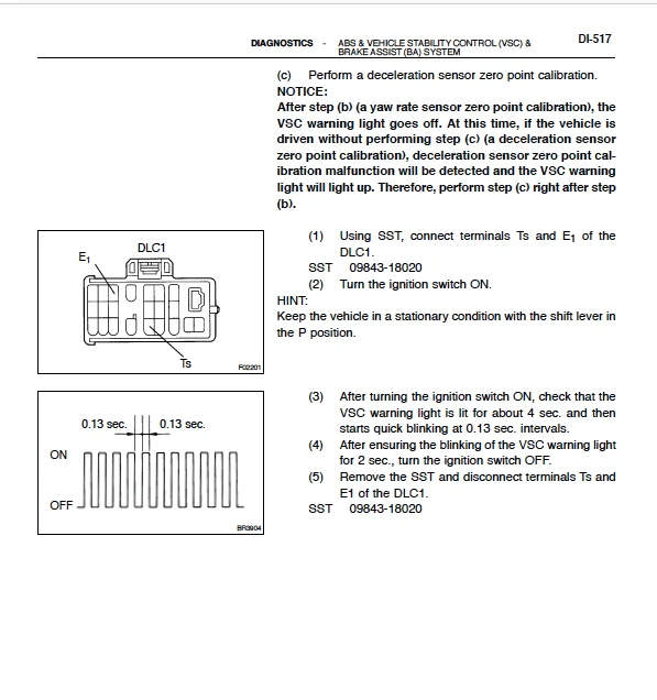

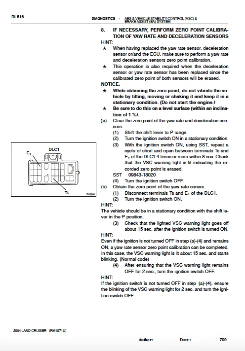

VSC light stops blinking in the instrument panel. See procedure description and Hints here:

FOUND IT!!! It is actually the TEST MODE of the whole Zero Point Calibration procedure just what Mauser said on the first reply of this thread. Perhaps I have a sucky Techstream cable but my truck just doesn’t respond well to Techstream based ZPC. Thanks for all the helps folks 🙏
Did this yesterday on my 06 to center the steering wheel using the Techstream VGRS utility, then did the zero point calibration using the VSC utility. Two steps, one to reset the memory, the 2nd to do the signal check following the attached TSB.
I used my Windows 10 Surface, Techstream 14, and v1.4 cable...
