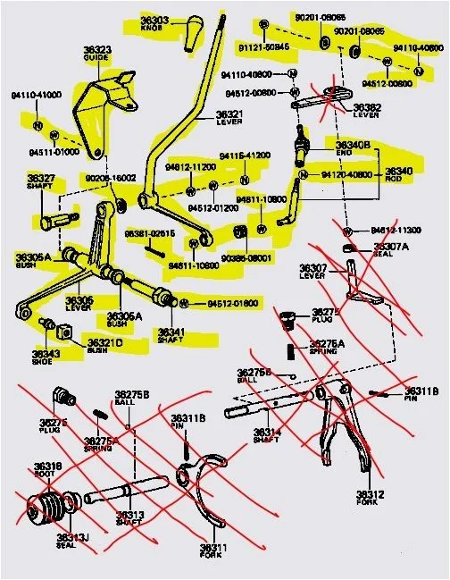

There has been some inquiry on the items needed to complete this kit. Please reference the following diagram for the donor/used parts you will need to source from a vehicle matching the era of your transmission selection.
Parts you would need to source.

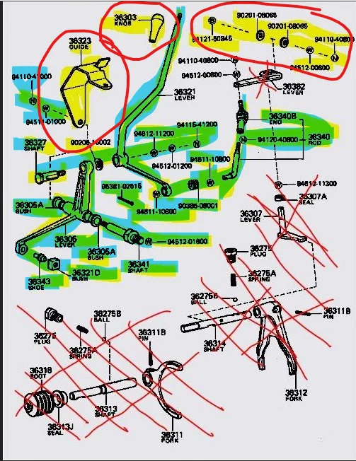

Are the parts in yellow still needed if you purchase the TCSCSHFTKIT and the 2WD-4WD T-Case Manual Shift Conversion Kit ?
Nope, the TCSCSHFTKIT covers most of them (shown in blue)
The knob (36303) is as easy as choosing an desired style, we stock many:
The shift guide (36223) isn't necessary, I like leaving them off so I have 2L :D
The bolt set for the hi-low lever can be re-used from your old lever or we offer it too. Ping our parts team at the shop if we can be of any further assistance: info@cruiseroutfitters.com
