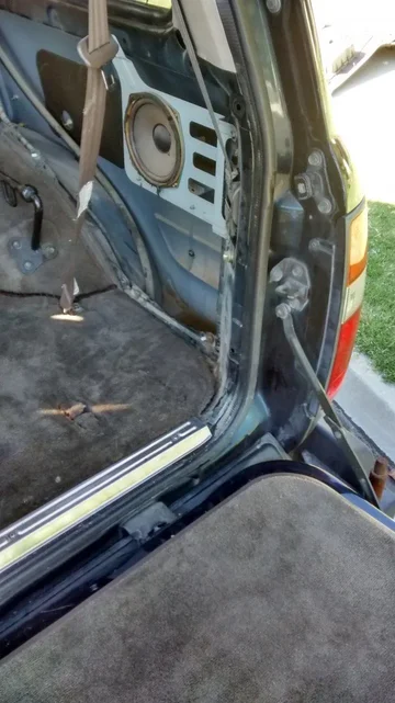

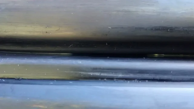

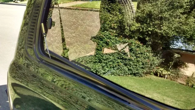

The subwoofer area and part of the trunk floor got a lot of water in. Upon a close inspection and after reading some other threads here, I found out the trim under the third window was very loose and unable to seal properly.
In three days or so there will be one more rain storm hitting our area, so I'll see if my work will pay off. 2014-12-13 11.05.23.webp2014-12-13 11.05.23.webp2014-12-13 11.05.29.webp2014-12-13 11.05.38.webp2014-12-13 11.05.47.webp2014-12-13 11.05.57.webp
I tried to clean up every little bit of silicone that covered up the draining holes under the window, so I won't create a bigger mess than the original one. 2014-12-13 11.31.28.webp2014-12-13 11.31.32.webp2014-12-13 11.31.36.webp2014-12-13 11.33.21.webp2014-12-13 11.34.03.webp

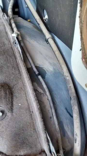

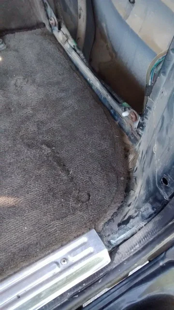

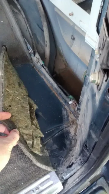

The trunk is wet again.
Yes we had rain in California, still can't believe it. It came down hard yesterday.
I had a good run with the previous rains we had here for the past 5 months, no issues until yesterday.
Same area was wet, unable to determine where the water is coming from. The window sills look dry, no sign of water getting in from that area.
Where's the water coming from? The roof liner looks dry an clean. No roof racks. I can't figure it out. I need to get the water hose out and spray it until I find the new spot. Hopefully I won't get a ticket from the water nazis.

I'll have to pay attention to the top of the window and the side of the vent. It seems to line up with the area that gets wet.
I just can't see though how the water would get on the trunk floor in that corner, if the water gets in from either the top of the window or the side vent. It would go down/drip inside the well below the subwoofer the way I see it.
I looked (not tested) the hatch seal and the door in that particular corner. It's closer to the wet area.
I got to use the water hose, otherwise it would be hard to nail the area in need for a fix. The sponge behind the cubby is dry. It used to get wet prior to my resealing the bottom of the window.

I put my hand deep inside the panels to see if there is any water. There was none, just damp. I need to check the other side, DS, just to be safe.

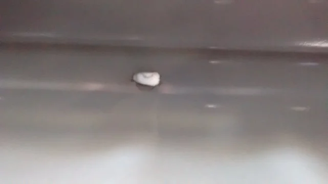

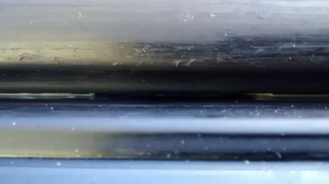

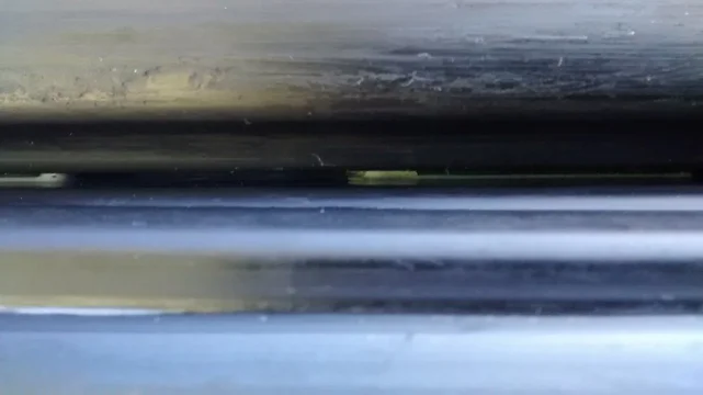

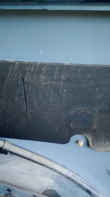

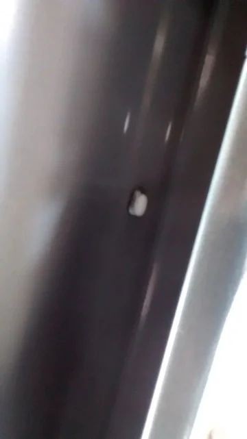

I found a couple of sources for the water leak. Shot a short video so you can see better. The rubber seal around the hatch )in my opinion) is at fault and a little improperly sealed hole behind the bumper.
I'll post some pictures later too.
I am having some slight leaking also and have pinpointed the rear hatch rubber. Like the sunroof, it is probably shrinking and not applying enough pressure against the door.
At the top of the opening, water will drop directly onto the spot you are saying is wet.
To test this I was going to run a piece of masking tape across the top of the rubber to act as a dam. It should keep enough water from sitting on the horizontal part so the leaking may not occur.
Old trick, dry the area out as best as possible, 'puff' talcum powder into any suspect areas, close the car and let it rain. Later you will have 'tracks' in the powder leading you to the source of the leak, when it is dried out the tracks are quite solid so will stay around for awhile.
