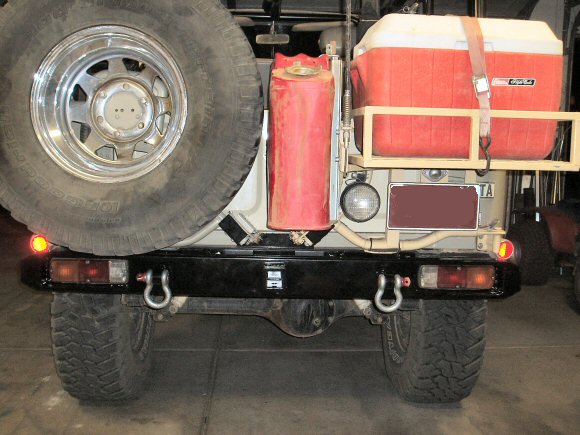

Cliff, nice work there. The actual tire carrier looks like a stock tube-style carrier, but so does the cooler carrier on the passenger side. Did you have to mod that to get it to swing correctly? I understand you had to mod it to hold the carrier, just wondered about the hinge.
And did you reinforce the tub where it bolts? Could you post a pic of the inside of the tub?

Stock tube carriers they are indeed. The hinges can pivot 360 degrees. I took them apart for powdercoating and some new bushings. I made a backing plate for the upper inside. Not much more than a really big washer, about .060 thick. The bottom part of the tub is reinforced there already. Not much weight in the cooler rack anyway. And when it's closed the rest supports some weight too. It's been trail tested for several years now, no problems.

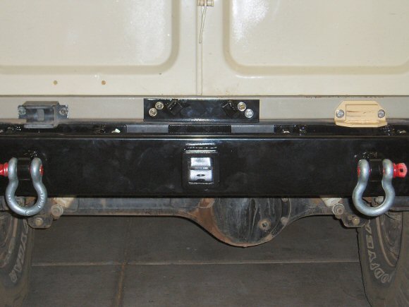

Yeah, it locks closed and anywhere open. It's pretty nice, but I used a coarse spline hub so I had to use an old Warn locking hub on there. It takes almost a full turn to lock it. It would have been nice to have an aisin or other that only takes a 1/4 turn.

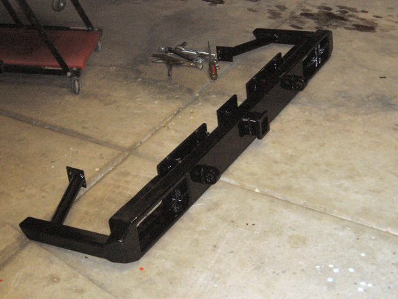

So, when we last left the shop Cliffy was worried that the powder coaters wouldn't make the deadline for his 4th of July trip to the pines. :confused:
He was right. :crybaby:

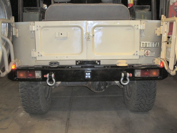

He had to go bumperless. But finally the finished product is installed. Ready for the big show in Gunnison Colorado (MHJC All-4-Fun) at the end of the month.
Ready for the final wrestle lift into place
Too clean, must get dirty...
Latch mods in place

cliff, how much did it cost you to get the bumper powder coated?
My records indicate.........
$47.92 for the bumper and 3 small pieces for the carrier latches.
Pretty resonable considering the durability factor.
Nice bumper build. I'm about to do mine.
How have you managing water out of the light pockets? I didn't seen any drain holes. Accumulated water or mud can start rust.
