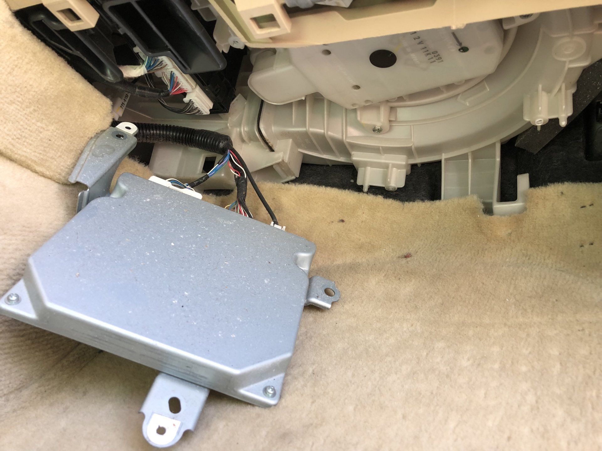

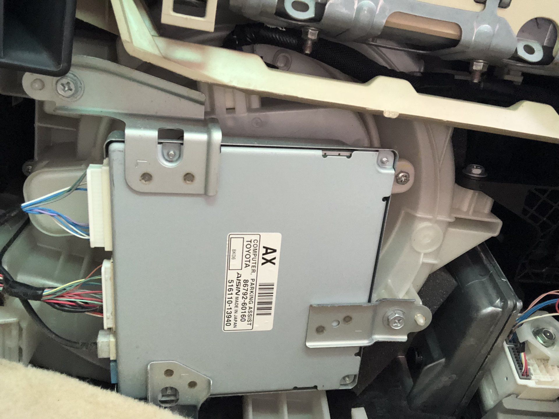

Glad you got it repaired @TWillz. The noise was driving me nuts.... Your parking assist radar controller looks completely different than mine...what year LC? And yes, the wiring jack on the fan assembly was the big dilemma....but after removing the three screws, I thought about what @ForrestGrump said about his literally falling out after bumping the glove box. I lowered the fan to the point that the plug was resting on the lip protruding from the back side of the glove box, then pushed / tilted the fan assembly back (towards the front of the truck), and it fell right out.
As you said, best $150 I’ve spent in a while!
@TWillz interesting shot of your radar control. Mine wasn't attached like how yours is. It only had one screw close to the firewall. Wonder if it has something to do with model year (mine is 08). Glad this helped both you and @Tommy Dwyer!
Mine is an '09 LX. If you guys both have LC's, I'm wondering if under the dash could be slightly different between the two models?

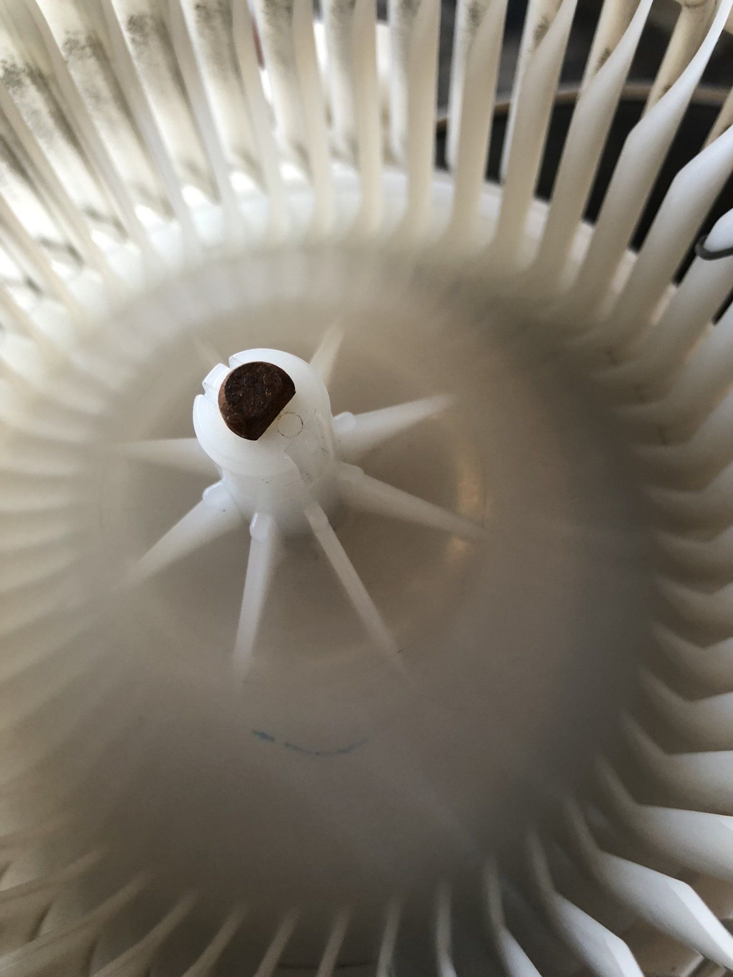

So this rusty spindle is causing all of my AC noise?!?! Crazy that this is at 64k miles. Anyone have Toyota replace it as part of extended warranty? Seems ridiculous to happen this soon.
Should mention that the shaft spins freely and the noise changes as the speed of the blower increases. Coincidence that the sound started after two muddy trips off-road and a trip out on the dunes?

Could be....can you feel any play in the bearings of the fan / motor assembly?
Stinks that this happened at relatively low mileage...
That’s what mine looked like at 120,000. Replaced the blower and no more noise. I swore I could feel a vibration in the steering wheel as well. That also went away after the replacement.

My replacement blower came in on Friday afternoon and I was able to get it installed. Took me almost an hour to get the old one out but after re-reading this thread several times I managed to get it out. Thanks for your tips on this install ForrestGrump! I ended up having to remove 3 bolts to get the radar unit out, then another 3 for the blower assembly.

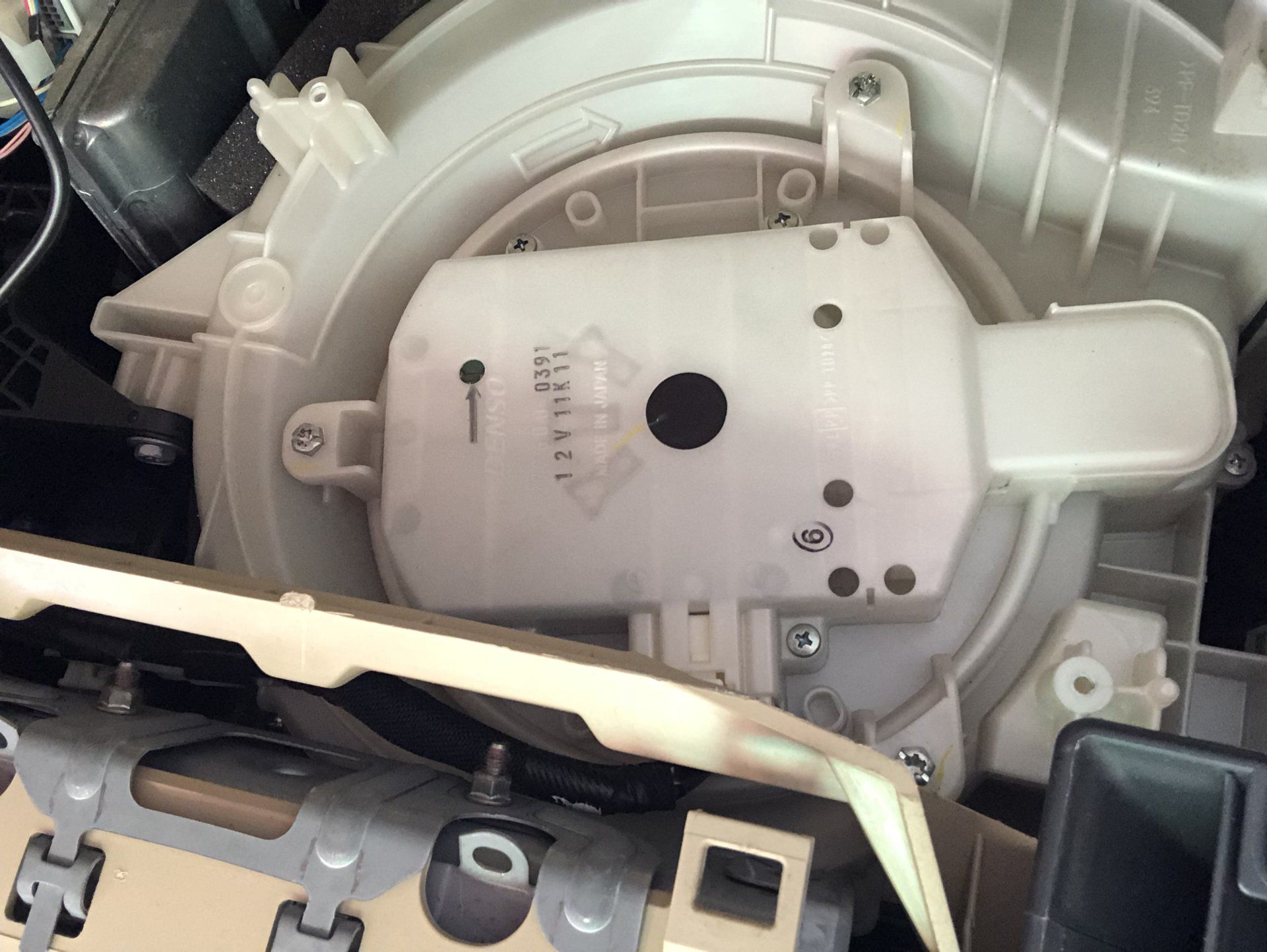

Once this thing is off you can see the blower and the three screws that need to come out of it to remove:
Here's a close up with the lip of the dash that makes it kind of a pain to remove the blower. The connector is right above it and it's tight in there...

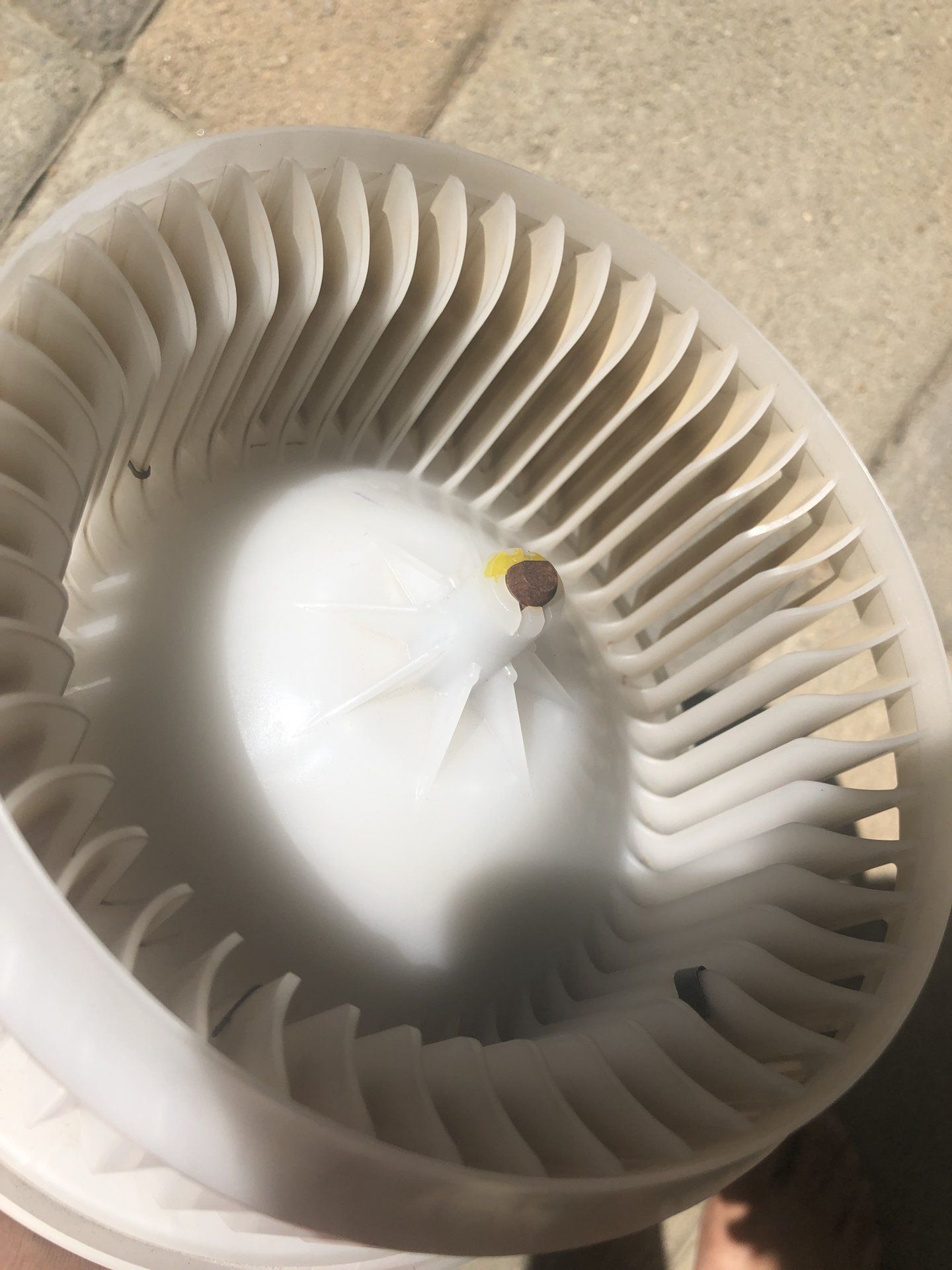

Here's a shot of the rusty old spindle. This thing wouldn't spin around easily at all. i can see why it was so noisy and vibrating so much.

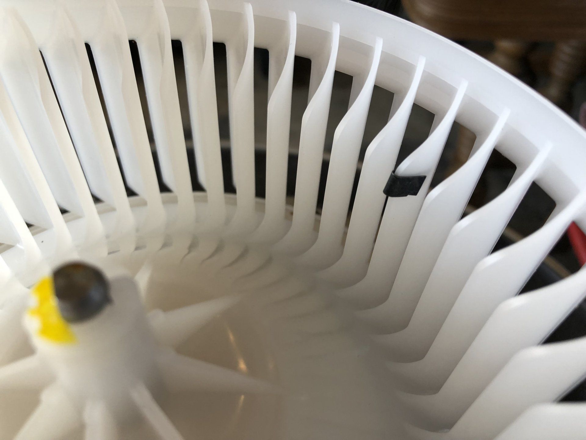

And finally a shot of the new unit - this one had a metal clip on one blade (I'm assuming this is for balancing) and then the blade directly across from that one had a small piece of black tape which is probably also to balance the fan I'm guessing.
The new unit is super quiet, all my vibrations are gone and it blows strong. This is easily the best 150 bucks I have spent on this truck to date!
