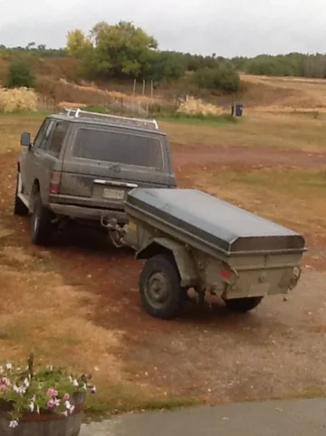

well I picked up the lid today. I was supposed to pay $265 +tax for it to be bent and I'd weld it up. I showed up and paid $250 cash. when I went to pick it up in the yard here is what I got
all welded beautifully. fits like a glove. I was a little disappointed at first I wouldn't get to weld it with my new mig but there lost of other stuff on my welding list so really I'm ok with it. it's way better than I'd do anyway. I have e hinges ready. just need to find the right latches and lift struts.
one thing I would warn against with anyone else getting one built. dont use anyone else's measurements. go measure your own. I originally did and the guy asked me if they were inside or outside dimensions. I didn't know so went and measured my own exact trailer. it was in inch shorter in some dimensions and wider in others. there must have been some box variability over the years. I'm glad I gave him my own measurements because it really is perfect. I left 1/4 inch on each side for some play room and wouldn't change a thing!
