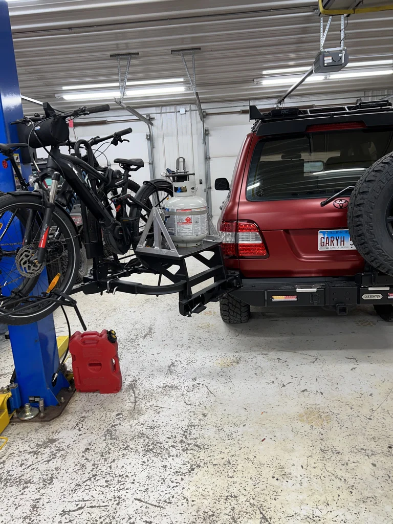

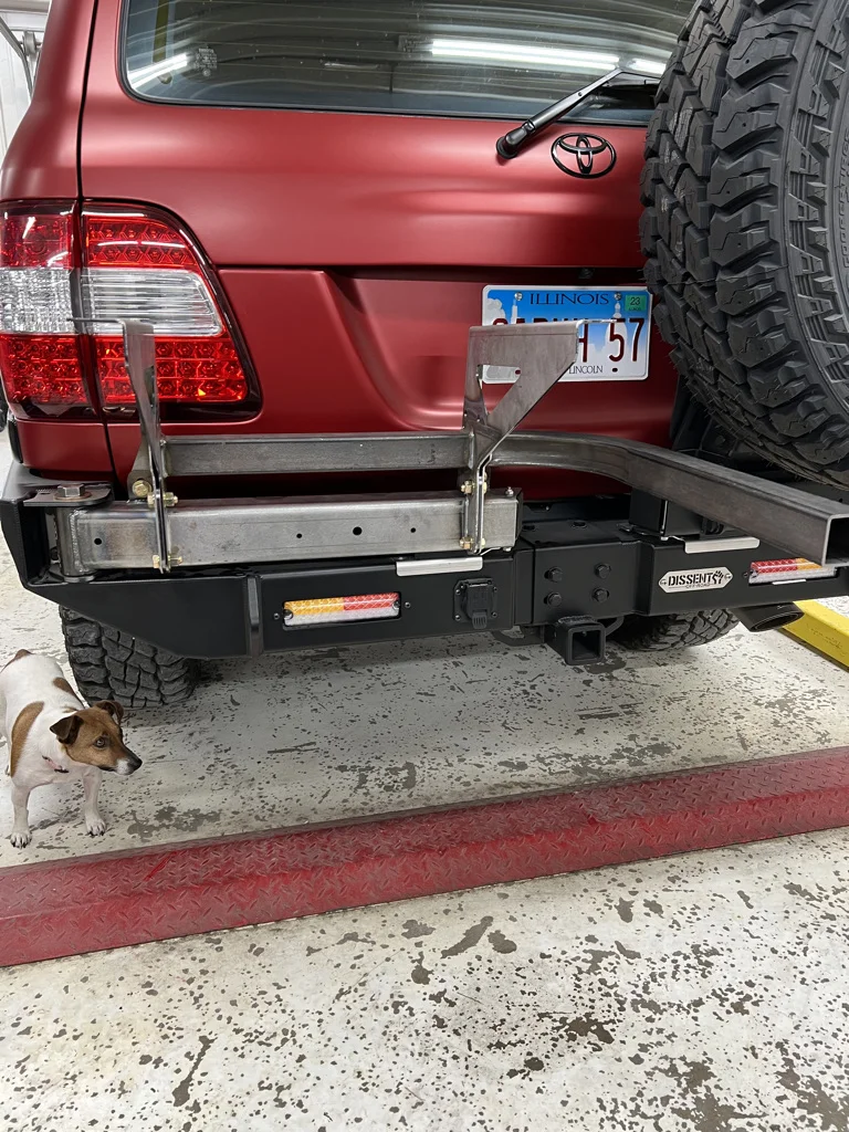

When I got the Dissent rear bumper in addition to the passenger side spare tire swing out, I ordered a bare drivers side swing out to set up a bike carrier.
I cut off the Dissent receiver tube that was mounted the the tray mount because I didn't feel like it was substantial enough to carry to e-bikes. I then bent a piece of 2" square tubing and mounted it to the tray brackets.
Got everything fit the way I wanted then had all the parts powder coated to match the bumper.

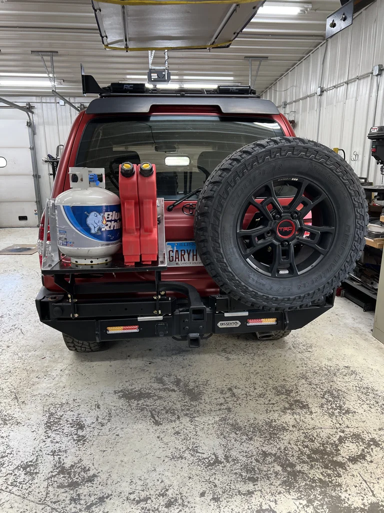

Then built a platform from 1" plastic, mounted some securing studs for a propane tank along with a strap stantion, and another stantion on the opposite side to hold two Rotopax containers.

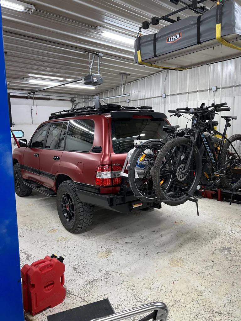

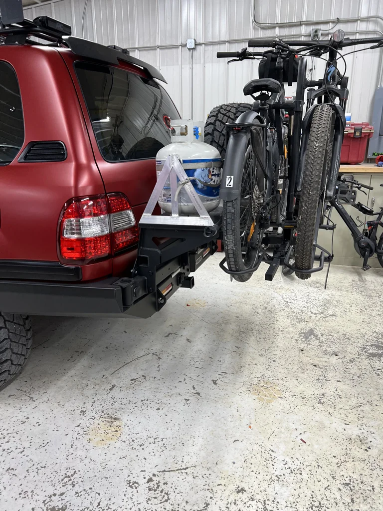

Now for the bike rack. I used a Holiday rack because my e-bikes have fenders and need to set in a tray. Pretty much a straight forward assembly with a few modifications for my application.

I like how you centered the hitch receiver for the bike rack. How is the flex/play with bikes loaded compared the stock Dissent version?
I have no flex at all. The stock Dissent version has a bit of a twist action. Mainly because of how the receiver tube is welded to a 3/16 tray bracket

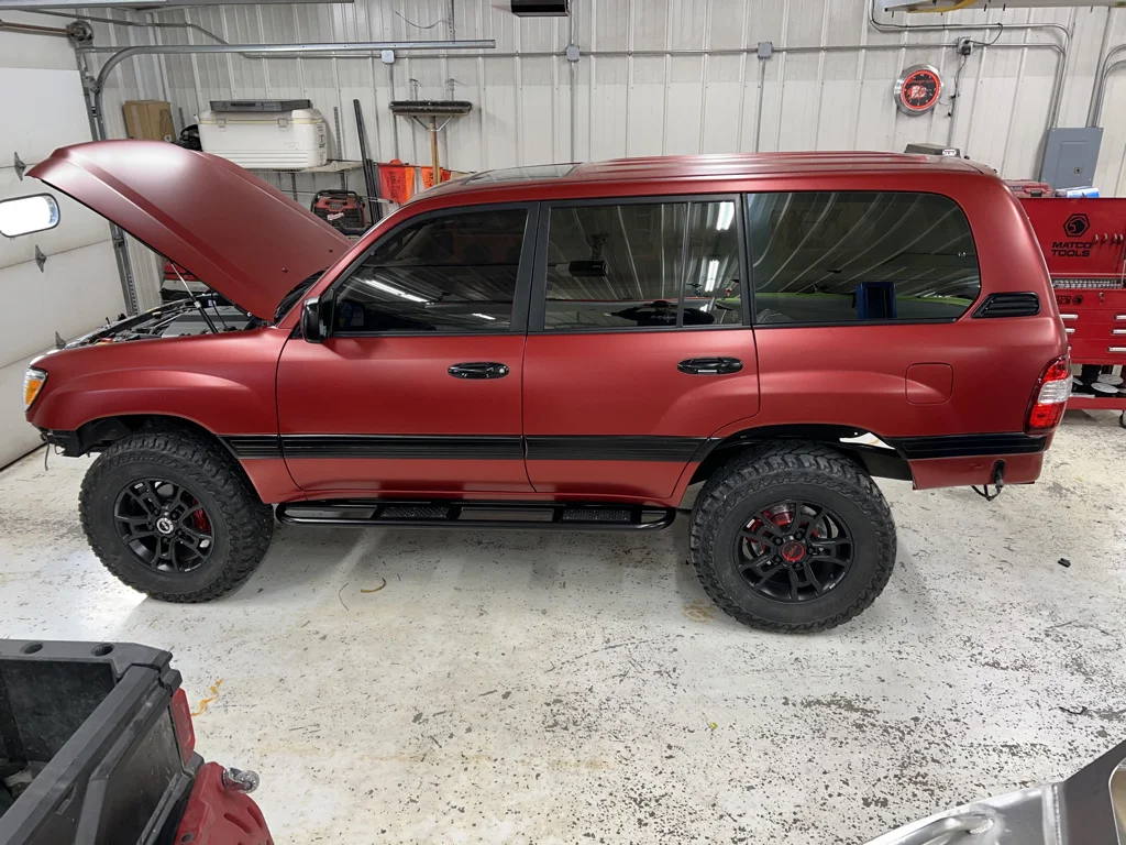

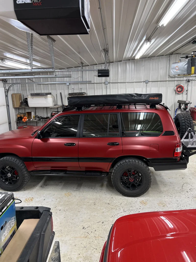

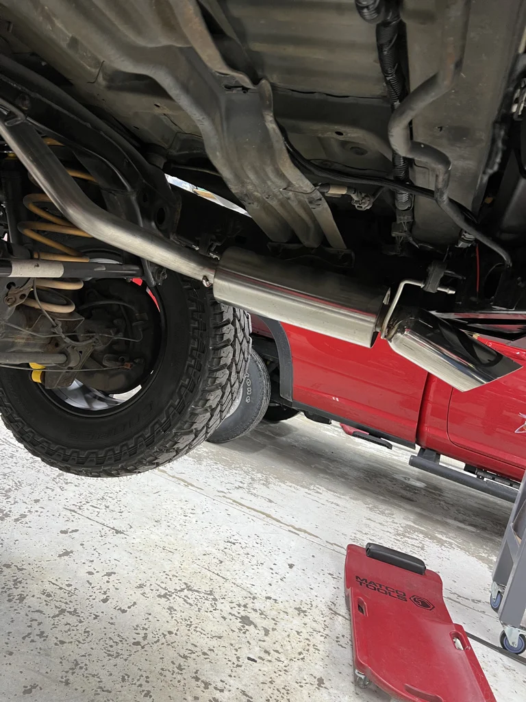

I scored a set of 5 - 18"x 8" Toyota Pro BBS black wheels and am using Cooper LT295/70R18 Discoverer S/T Maxx tires. Hurican tailgate storage kit was installed. While working on the interior, the steering wheel was replaced, gear shift knob replaced, and gear indicator plate was replaced with ZR Tactical Solutions billet shift plate. We won't spend much time mentioning the K&N Cold Air Intake System since that seems to be a controversial topic.;) Installed Borla cat-back stainless exhaust. (really does sound sweet).

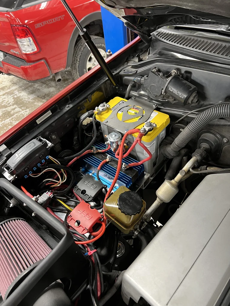

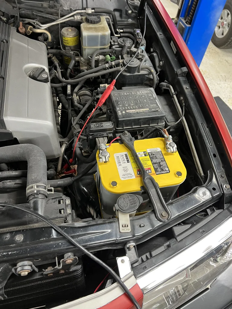

Aux Battery setup ......... I built a custom fit platform for the right fender well. Installed a Otima group 35 yellow top battery for the OE replacement. Then mounted a Optima group 51 yellow top on the passenger side for the aux battery. Along with this I used a CH 48160 battery isolator to connect the two with the alternator. Then a solenoid is wired in to connect the two batteries in case the main needs help in starting. This solenoid is operated by a switch on the dash and simply completes a ground with the power coming from the Aux batt. From there I have a four - relay / four - fuse block that supplies the aux lights. Also a positive & negative post that the winch & inverter are ran from. The power steering reservoir was relocated to this platform.

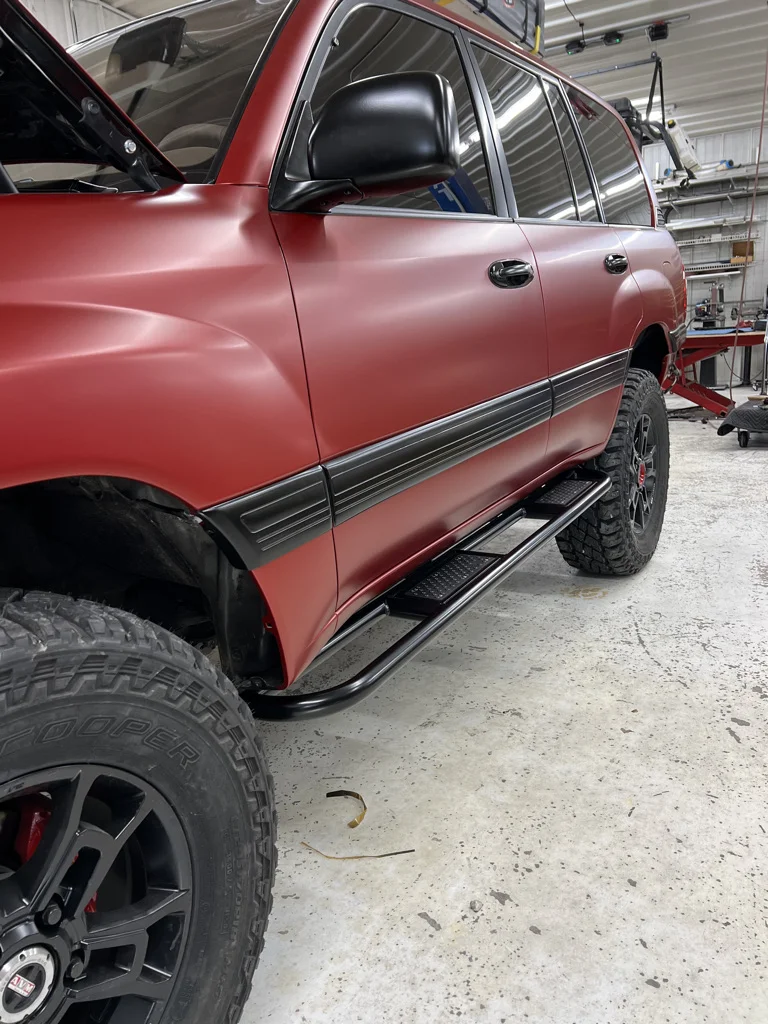

Sliders on the LC:

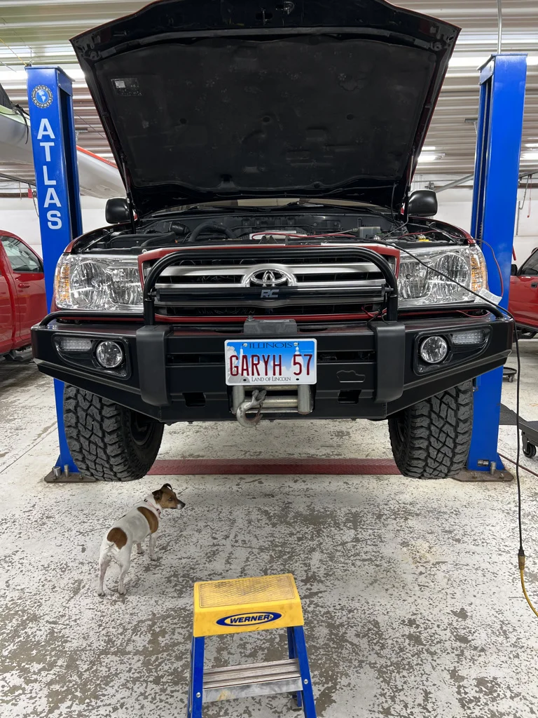

Front Bumper

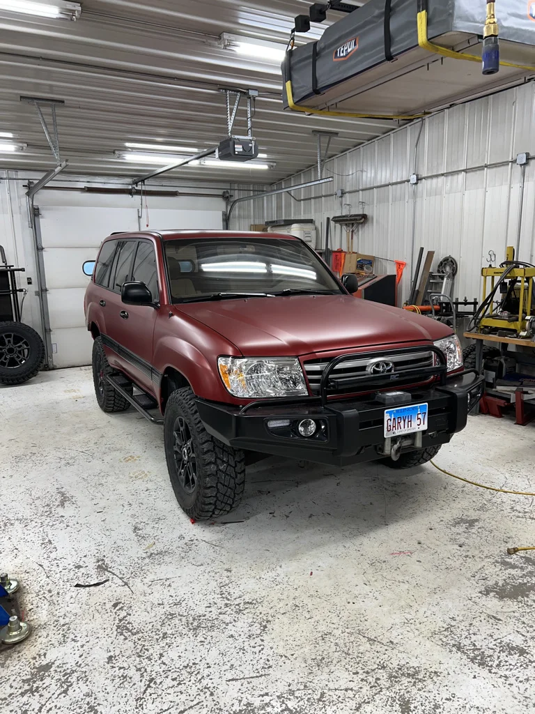

I switched the front grille, Headlight assemblies, lower valance panels, and rear light assemblies to '06 LC mainly cause I liked the look.

And just like that you’ve got a face lifted LC! Gorgeous man. Did you source all of the parts (headlights, taillights, etc) straight from Toyota?
