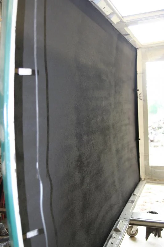

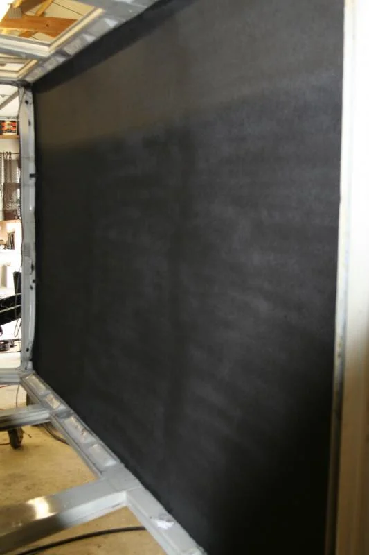

Here's mine, spray on Lizard Skin. Two products, Sound Dampener and Ceramic Temp. Control. Sound Dampener goes on first, then spray the Ceramic Temp. right on top of it.
Forgot the pictures

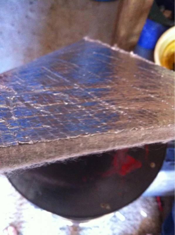

When I redid mine I had the same issue, I used a bottle jack a a 2x4 on the corners of the cross members to get it about an1/8 " from touching the roof itself. The sticky stuff that your looking at is called Seam Sealer. This is what the factory used to seal any sheet metal joints that tack welding wasn't an option. Fill the 1/8 void with seam sealer .Tack welding these cross members will pull the roof around as it cools and may cause it to warp or mis shape.You will find this product in various places on your truck such as between the upper and lower front fenders and around pillars to finish of the joint that have been tack welded.The insulation that is used between the roof and head liner is called Juet padding, it was a foul side and a heavy fiber side . I highly recommend this stuff. It keeps the cab cool in the summer and retains heat in winter.You can attach it by using contact adhesive in a old spray gun, spray the roof and the fiber side of the Juet then adhere. Try not to use the arisol cans of adhesive , it works like crap. Don't spray the foil side. The foil side should be down. A lot of folks spray the foil side and when it gets hot from the sun it separates and falls between the headliner. I have some scraps of Juet and have included a pic. It also works good as a floor insulator between the carpet or floor mat but stinks like a wet dog if you flood your cab going through deep water. Good luck.

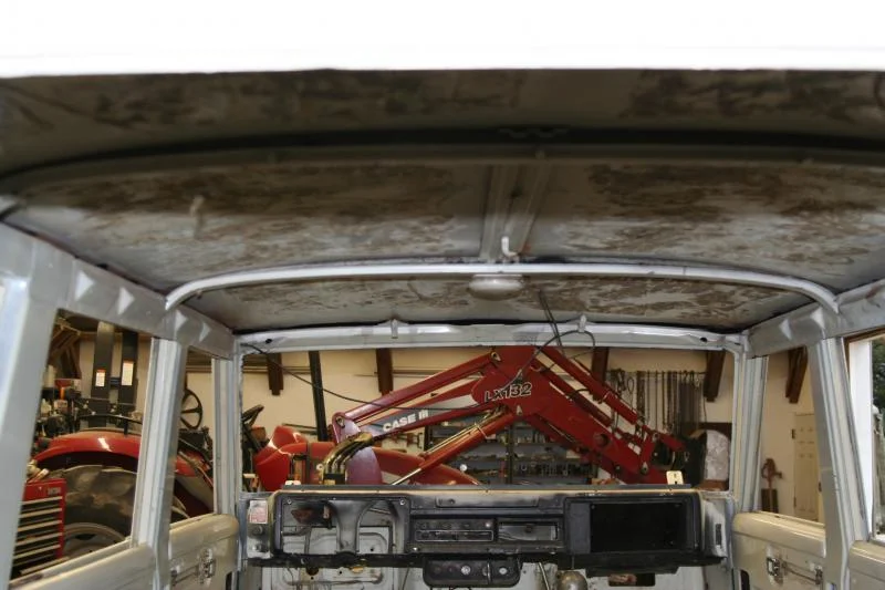

Lost the headliner and one of the roof supports at the time, bent up the other one too. Mine ('74) are/were welded in.
Re-installing one or two roof supports is on my to-do list, and there are several candidates at my disposal. I was thinking it might be nice to be able to bolt the new supports to the sides, with slots for the bolts cut in to the roof support mounts, so the supports could be adjusted up or down, depending on what kind of insulation you had glued to your roof. And so you could push the supports up to really support the roof.
Sorta stock...I want to use some stock supports, just more of them and bot-in instead of welded.
Lil' John,
My center support wasn't fastened to the rear support, either. looks like somebody had a dance on the roof. It doesn't take much, to cut the welds and drop all the supports. I'm going to add a third suppor, with another light, for the cargo area. Somebody posted about doing it, awhile back. Good idea.
Ahh, now the fun starts. I used a cheapo Multi Tool, with an angled blade on it, to get most of the glue. Also used some heat, to soften up the glue ( careful ).
You know what I used, Lizard Skin, really like the spray on stuff, works and stays up there.
I use a piece of copper tubing, that I flatened and shaped, so I have handle on the end. ( gets hot )
