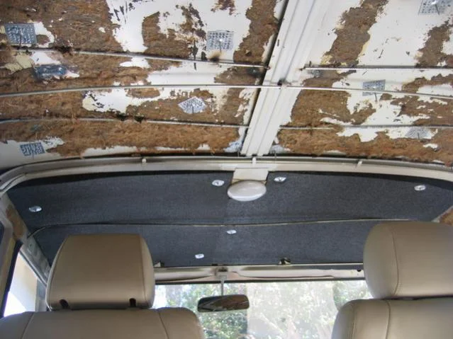

I can get some pix of this tomorrow in the day light. It's fairly ugly. I think if you cleaned and painted, it would make it okay. This is what I plan to do in the future.
Mine is quickly become that:crybaby: One panal is gone and others will follow. Maybe a truck liner product to replace it?:p
You'll have 2 flat cross bows, one that holds the dome light. You'll need to scrape off all the glue residue & paint it up. Either run the headliner or cut off the 2 bows & never run it :meh:

I have every intention of running a headliner... but the half tinted and half not tinted glass is driving me nuts... as is the now cracked windshield:bang:

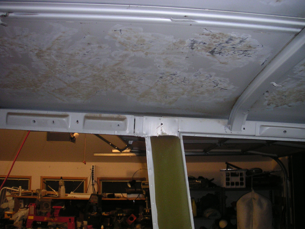

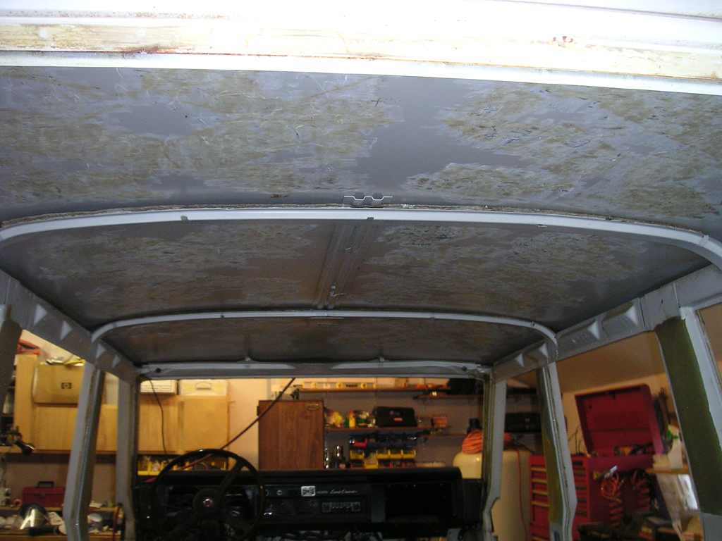

My Piggie was actually rolled once it's in life. We managed to push the bent windshield frame and roof back into place. It's pretty good, except for some dents. This is why I removed the headliner. I think if it was cleaned up and painted it wouldn't be too bad.

WOW Jack yours looks pretty clean after removal. I don't expect to have that luck (unless you've done some scraping that I didn't know about).
You need to do a bunch of scraping, I never got all mine off.
It is a lot more loud with no headliner.
Remember a properly installed headliner happens when all the window glass and rubber is removed.
The SOR liner looks great installed.
