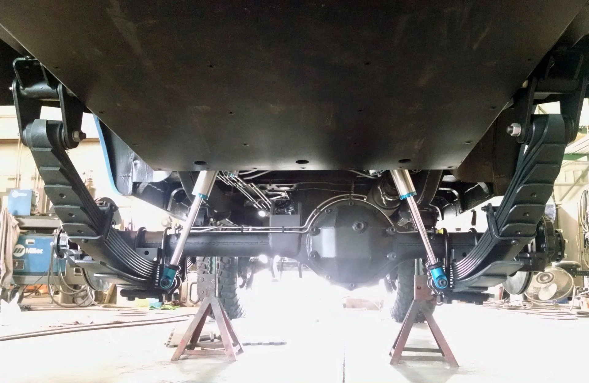

My goal is to be able to run the longest travel shocks I can run in the rear. I know that the Tahoe springs flex like mad. I'm not willing to run them up through the floor sheet metal at this time... I could potentially change my mind after I square away what is going on with the rear body and wheel wells.
FWIW, my sprung over 55 with exact same setup in the rear used the stock upper shock mount with axle shock mount exactly where the red dots are.
The number is a guess. Halfway between ideal (90*) and 45*. I'd assume they're not doing anything at or near 45*.
I have rear shocks that are about 65* and they are not very effective. I bet if you had a lighter truck it'd matter less though.

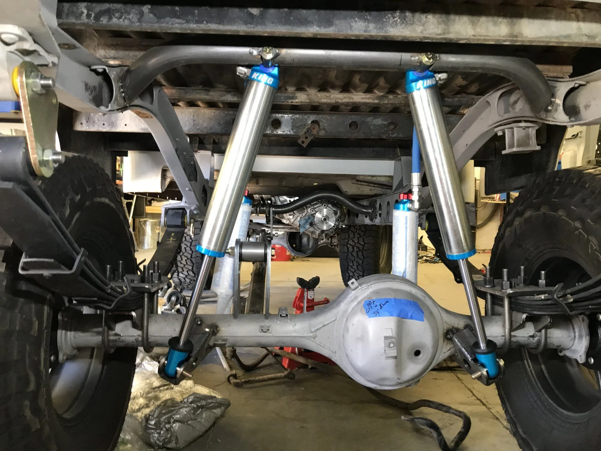

Just FYI, The tops of these shocks are almost touching the bottom of the floor and to keep them in a workable angle these 10” travel shocks needed to mount to the lower U-bolt hangers.
I built all the parts from 3/8” for the lower hangers and will send you the CAD files if it comes down to you needing something similar.
I built the rear frame side crossmember and angled it back and up. This gained me 1-2”. I then used a bracket axle side that was customized a bit. This is the result SoA with a 10” shock.

I'm trying to avoid putting something below the axle except for leaf springs. Goal is hoping to get 8" travel shocks to work. Yup, a challenge with non-spring over. I forget the travel on my green FJ55.
We wanted to utilize the full 10” of shock. At ride height it is 5” up and down. This was the only way I could get that done. The truck is not a rock crawler but still, why put in a 10” shock if not using its full travel?
